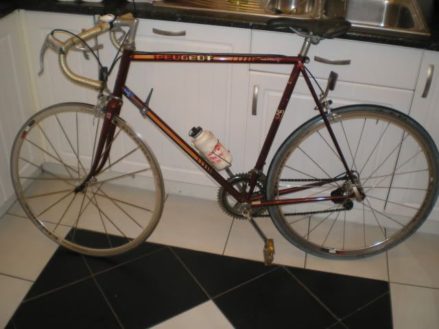

Hi all, picked up an early 80's peugeot in very good order.Even the chrome is in good condition,

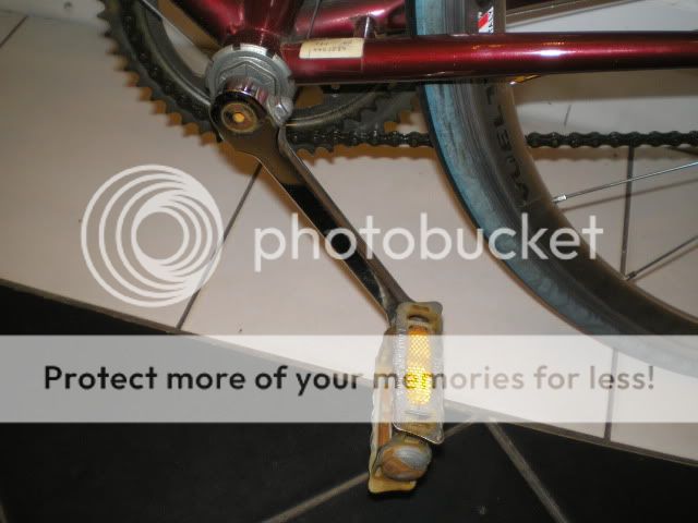

Have got some replacement wheels which were a bit wider than the originals but fitted ok.I would like to replace the cranks but I'm not familiar with this bottom bracket setup.Can I replace these with someting more modern and lighter? If so what would I need ?Also if I put an 8 speed cassette on the back will the original shifter /mech work ok. It was 5 speed

you have cottered cranks. you have to replace the bottom bracket to a never one with a square taper (or other system) to change the cranks.

you need a specific threading.
i guess you need a french threaded bottom bracket (rare, but just reintroduced by ben's cycles)
that's just a guess based on the peugeot being french. someone else will know for shure.

could be a swiss sized BB if mid 80's but as it had cottered cranks i'd say french....

I've decided to leave the chainset as is.It cleaned up like new and works perfectly.I kinda like the look of it as well. I've fitted the new wheels with an 8 speed rear cassette and apart from only being able to select 7 of the 8 ratios all's well.Went for a leisurely 10 miler yesterday and was smooth as butter.No rattles bangs or squeaks anywhere. Strangely I'm becoming rather fond of it :oops: :lol:
