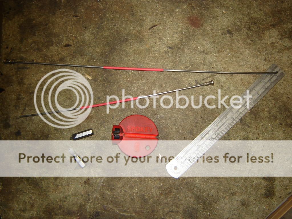

16 spokes :shock: I'd give that to a professional if it was me.
Having said that , you need to know the Effective Rim Diameter so you can plug it into the equation ( or calculators on the web ). You can do this with two cut spokes , put the nipples on , poke them through opposite sides and measure the gap. Add this to the spoke lengths and wallah ! you have the ERD.
I made one of these for pennies so I can read it direct off the ruler ( the red heat shrink is so I don't chuck it away ).

I have built only one wheel so far (with the help of some friendly retrobike forumers) so I wouldn't call myself an expert but it's important to measure the ERD in a couple of places because the unlaced rim probably isn't perfectly round. So measure in 4 sets of opposite spoke holes and average to get a workable ERD.
