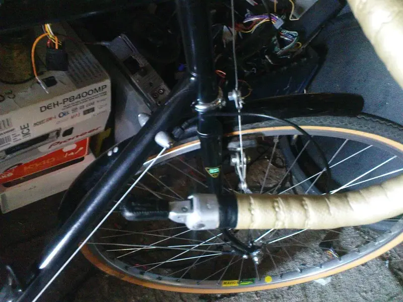

just normal gear cable will do - its just like fitting a set of down-tube shifters to you bars.

Suntour ratchet bar end shifters are easier to come by than Campag and work well, like the ones on Legrandfromage's bike. Simplex and Huret also made them in the 50's and 60's but they're not as common and, like Campag, they are friction only.
Use good quality outer cable, brake type is fine as there is no indexing to worry about. For inners you may find a long MTB type or even a tandem one which will be plenty long enough. Most people tape them up right to the top like modern hidden brake cables or coming out just below the brake levers. Both will work fine but lube the cables well.
