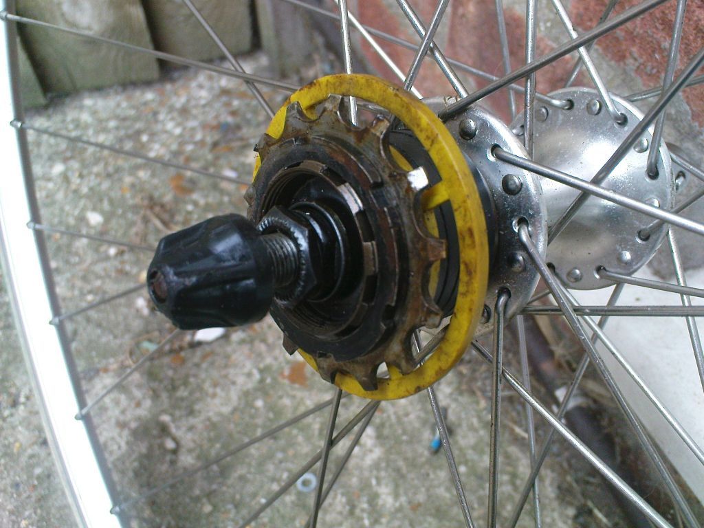

and I'll bung in a reply here:
just a suggestion:
Older 7spd Exage freehubs have a threaded section which the old cup & ball BB lockrings fit perfectly.
you could make yourself a decent 6spd cassette from a 9spd (for the ratios) using spacers from a 7/ 8spd and a sexy lockring from a BB.
Not period correct, but would keep everything running for as long as you needed.
heres what I mean with a shite SS conversion made out of workshop floor sweepings:
