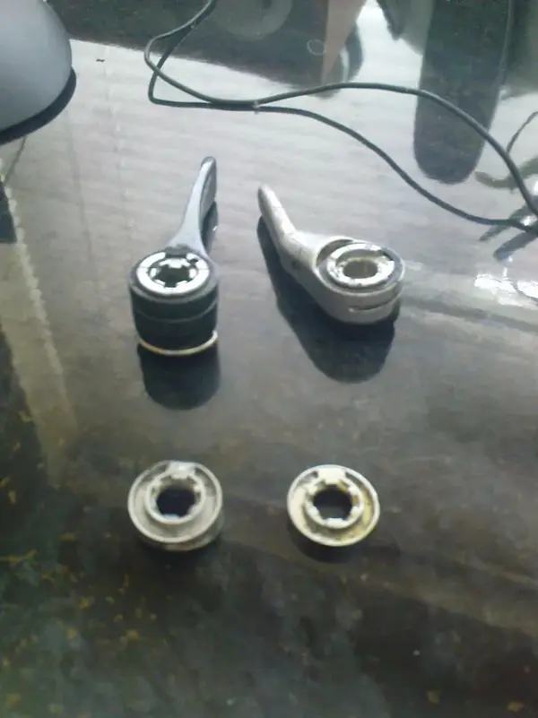

Standard Shimano down tube shifters should fit as the barcons and the downtubes both have the same mounting bits

I thought the downtube levers had a curved back spacer plate that fitted over the boss ?
The barcon mounts had a dummy boss, but a flat baseplate. :?
the spacers are interchangeable
