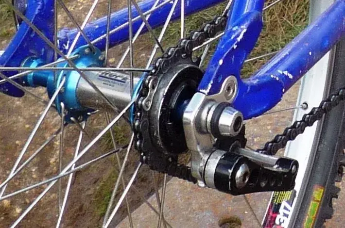

I use screw-on rear hubs, re-spaced for reverse dish on my singlespeed - much neater than a freehub conversion I think. Plus a really spanky hub can be got very cheap.
