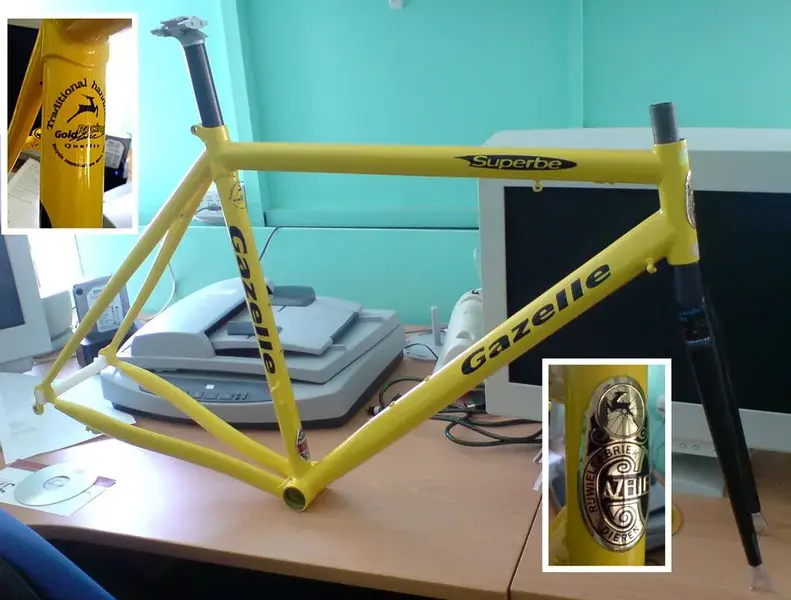

Here is a quick shot of the frame and forks, the only parts I have are an ultegra front mech - modern (ice grey) and a Use Carbon Alien post.
I will probably get a matching rear mech but I don't like the matching Ultegra cranks, I'd prefer older carbon ones.

Also does anyone know what the dangling boss is for on the top tube? (below the b of Superbe) It faces sideways.

The dangly boss is for a race number......................

thanks Fat fixie - makes it look more like a race bike then
