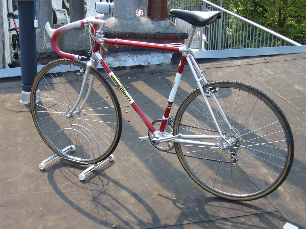

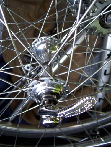

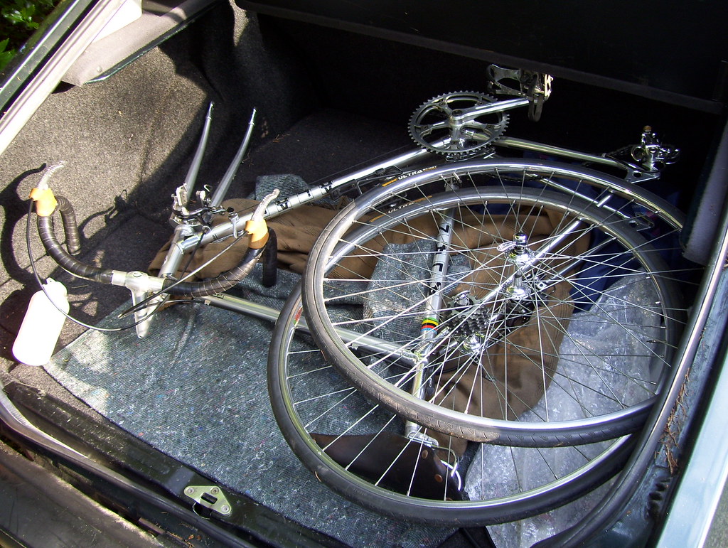

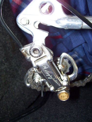

Happy to got hands on this one :) Lightweight bling al chassis with nice candy allover. Pics give an impression. Of course I will get it out my car and make some proper pics asap :wink:
50th mech :) >
fresh hoods :) >>
former owner did a good job on polishing the parts :) >>>
Brief speclist:
much Super Record
50th r-mech
black Dura Ace brake callipers
Cinelli cockpit
Brooks Professional
59cm, my size 8) Confident this will be a great rider.
