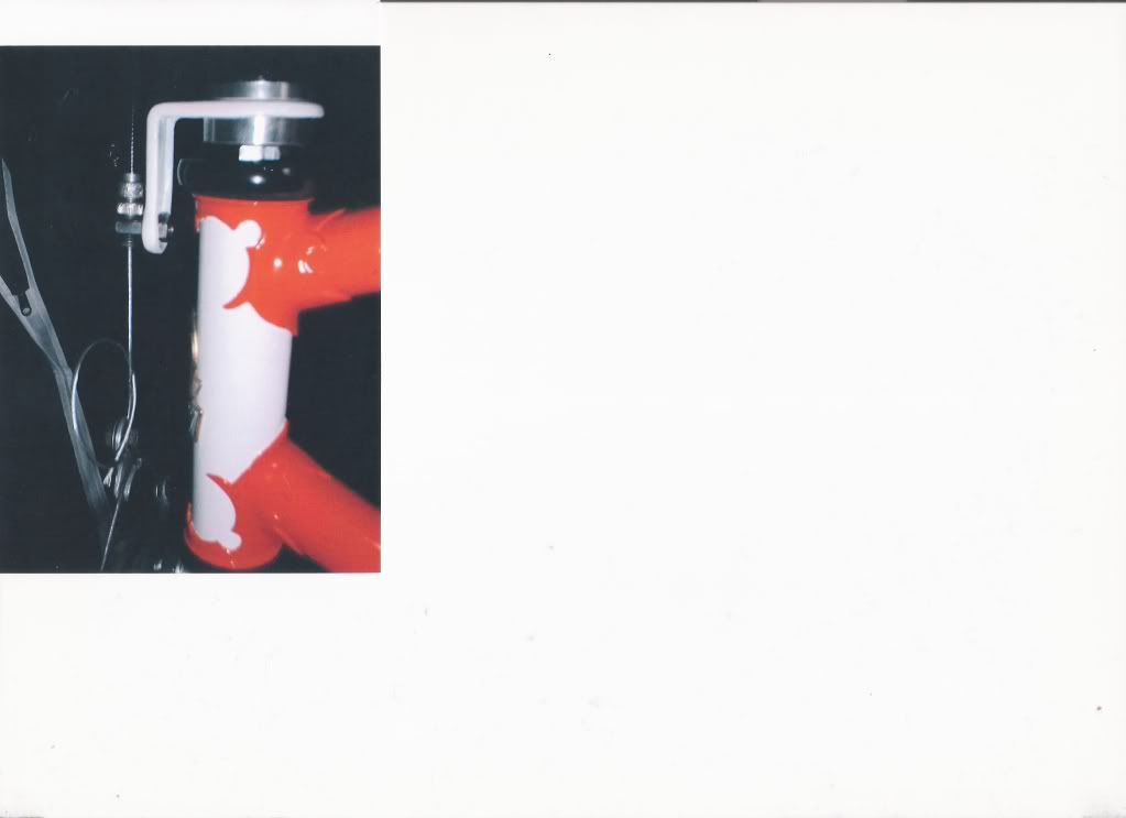

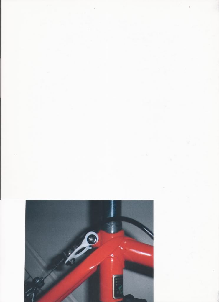

A driver who collects from our site has just been restoring his Viking, heres a couple of pictures of lugs:
He bought it new as a frame only from Roy Anstee Cycles, Bargoed where he had a Saturday job in 1964. It stayed in the family & had languished in a loft for 30 odd years. The shifters were band on, & the frame no. is just 6 digits. I had to scan these pictures in from prints, I'll see if I can get a shot of the whole bike soon (might take a while!).

Thanks for this. The lugs are the same- the front, which you can't see in your photo are "fishtail".
http://www.classiclightweights.co.uk/co ... ervex.html
Having looked at the various catalogues on the net, I reckon it's possibly a "Conquest". I've bought a fixed gear and ridden it a bit. The fork threads are a bit ropey, so they keep coming loose. Can I rethread?
