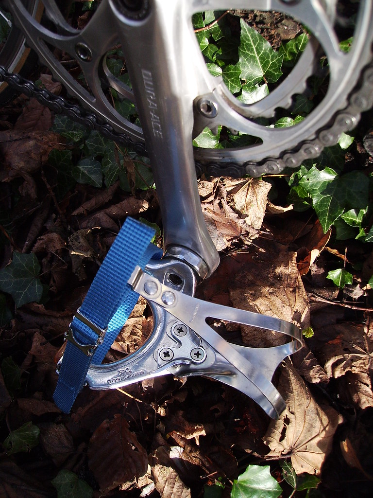

Practical implication is that the cranks design limits your choice to using 'DynaDrive' pedals only. Still some, like me, prefer using conventional pedals, with a cage, or 'clickies'. So than you have a problem :roll:

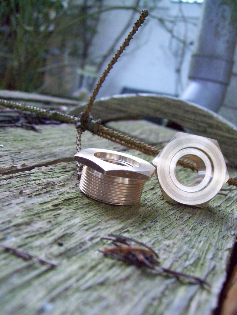

My LBS had something made that makes it longer necassary 'to bin' your expensive DD crank if you want to use something different :)
adapter pieces.
8)

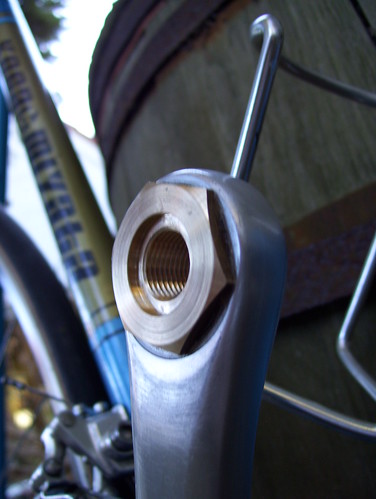

Nicely constructed with material machined away where the pedals fit, so to prevent you will end up with a skyrocketed Q-factor.
Fitted:
Image Image
No pics if finished result with pedals - yet

I can't imagine there being a huge market for those adapter bits, did your LBS just have them laying around?
They are quite nifty, if a bit ugly.. Can you install them from the inside out, so the hexagonal plate is on the inside of the cranks where it would be less conspicuous?

My LBS had them made. Shimano is even directing people looking for a solution to my LBS. I think there are made in a time when people were simply looking for a practical solution for their compatibilityproblem, hence they are no aesthetic delight probably. If you want the authentic looks, like many vintage conaisseur want nowadays, you have to go with the original DD pedals or alternatively swap the DD cranks for regular DA ones of the same era. The LBS still have them laying around. No cheapies though. I bought myself only two pair. I sometimes got hands on full DA specced bikes for less :roll: That is the reality with vintage bikes I think.
I thought of mounting them from inside out, but I do not recall whether I actually tried whether they would thread in. Anyway, I am sure I would have to tighten them very much, to avoid unthreading when pedalling.
