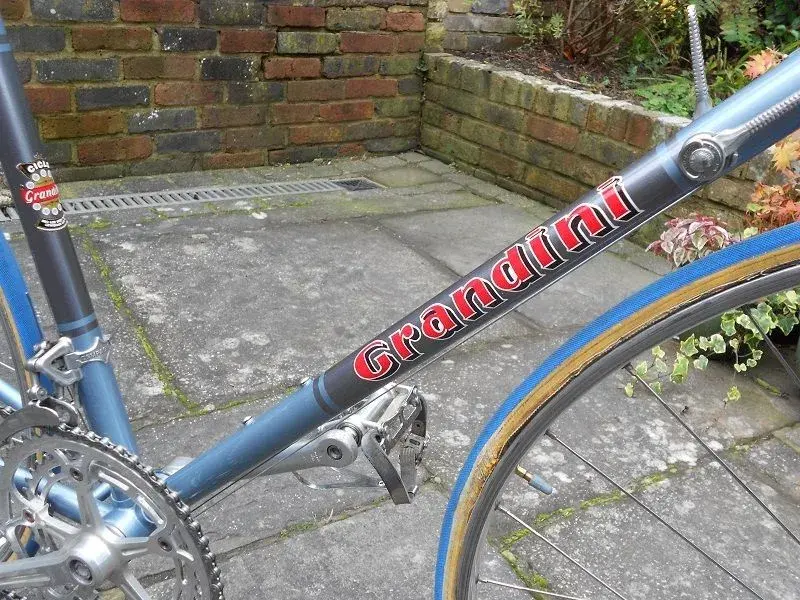

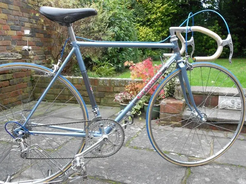

This is the last bike I restored, a quick rebuild that only took a few weeks, currently looking for something to pique my interest but with the lockdown and consequently no bike jumbles there is not much material to be found.

Very nice. Any idea of the date? Going by the underbracket cable guide I would reckon early 80's perhaps? However, the long Campag ends and long(ish) chainstays might not add up. The seat stay top, with what looks like extended seat lug and the shot-in stays, is very reminiscent of my '72 Dave Russell built by Bill Grey. Wasn't sure that Grandini were still around in the 80's TBH. Often advertised with Youngs. Metro and some other odd brands in the 60's. I'll look for some adverts.

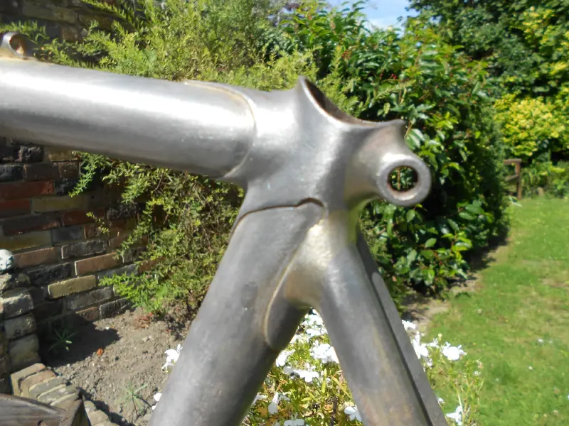

Thanks Ned, Grandini was the up market side of Youngs cycles when they were in Lee High Road near to Lewisham. In fact they sponsored, I believe, an independent bunch of guys and this must have been in the '60's. I would estimate the bike to be a '60's manufacture, the under B/B cabling is just something that was done to modernise the frame, and not by me I would add. In doing this unwanted act the original frame number has been ground off so there is minimal chance of any accurate dating. The seat tube and rear stays lug was, I'm told quite unique to the Grandini although there was a similar affair on some top of the range Carltons. The additional pic which was taken before I painted the frame clearly shows this lug arrangement.
I would add the bike is super light and with those 28's it fairly flies along.

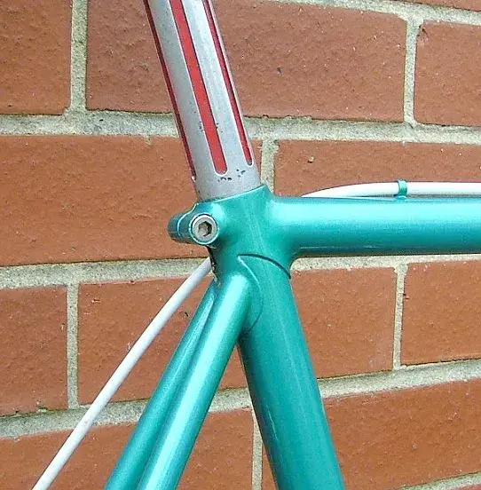

Here's my Dave Russell seat lug.
Very similar. I wonder if Bill Grey did some building for Youngs/Grandini? He was a freelance builder.
