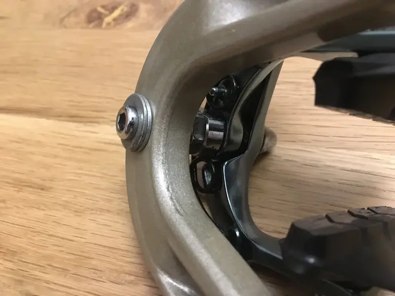

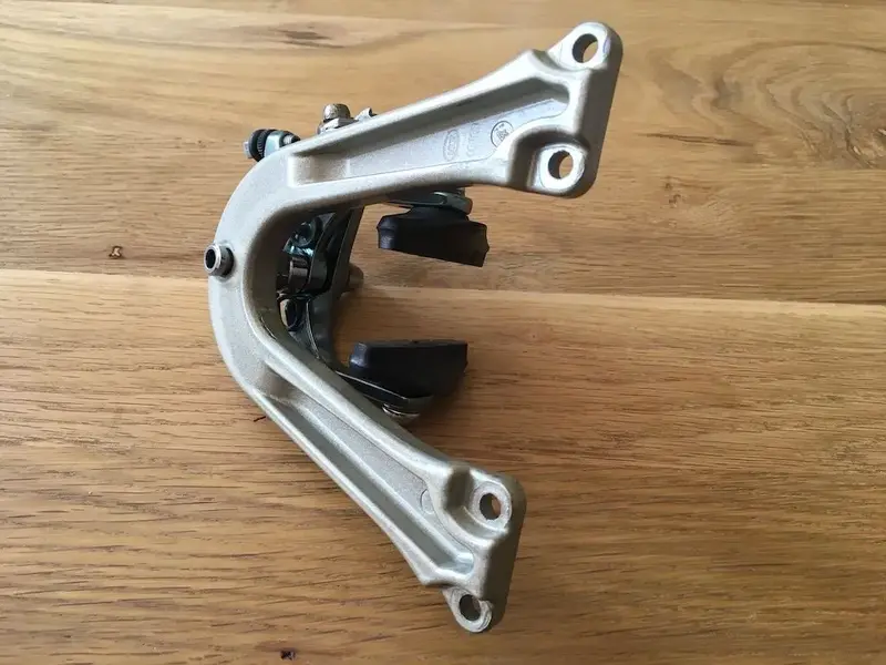

I'm building up a Bridgestone RB-1 with a RS Paris Roubaix SL fork.
I have an issue that I can't seem to solve and I don't know what I'm doing wrong...
When I install the front brake calliper, the fixing nut at the back of the brace doesn't sit flush against the brace. I'm worried that this will put undue stress on the brace in the incorrect places. I'm also concerned that the nut will come loose because I'm hesitant to tighten the bolt (because it doesn't sit correctly).
The nut I'm using is 10.5mm. The shortest.
I've attached 2 images that I hope will help with the explanation of the issue.
Please will other users of the RS Roubaix fork share their experience of installing the front brake calliper and if there similar issues experienced.

I had this before on someone else's bike the simple solution is to cut the hex nut down or put a spacer between the fork and calliper I choose the former option he's been riding it for a couple of years with no dramas. I did try the rear brake in there which has the shorter stirrup bolt it tightened up fine with the 10.5 nut.
I'm using the rear calliper on the front, exactly because the fixing bolt is shorter than the normal front calliper bolt.
Again, I can tighten it up, but I bothers me that the nut at the back on the brace doesn't sit flush.
Would it be safe to cut down the nut to, say, 7.5mm?

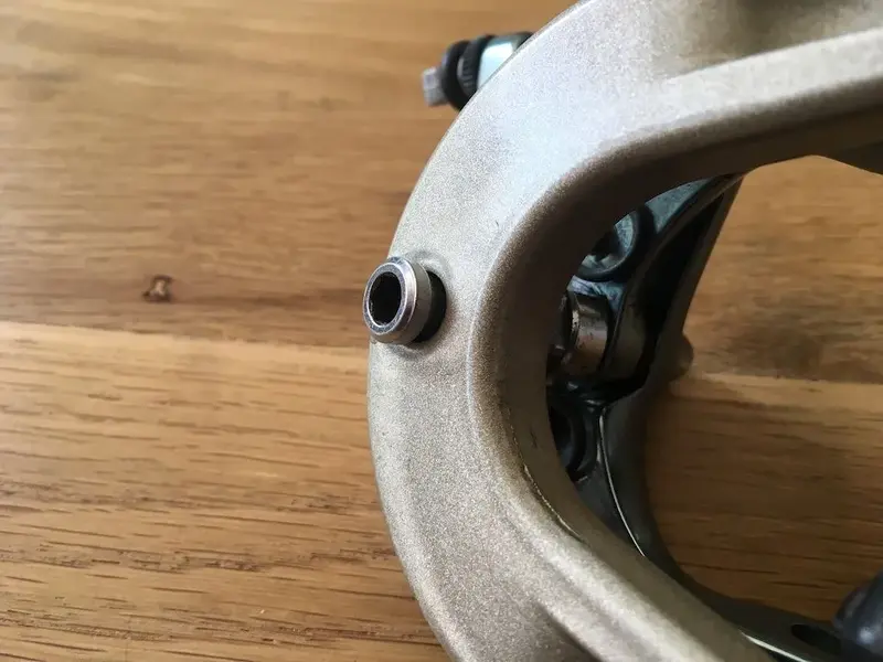

I've added 2 washers to the nut behind the brace. It's an ugly solution, but it appears to allow the nut to seat better and tighten better.

Yea that does look ugly I would cut down the nut to 7.5mm and make a tidy job
