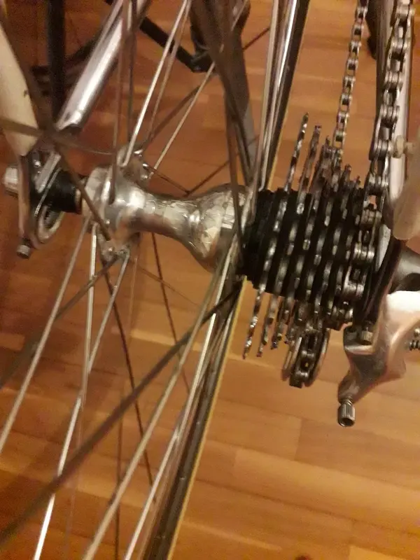

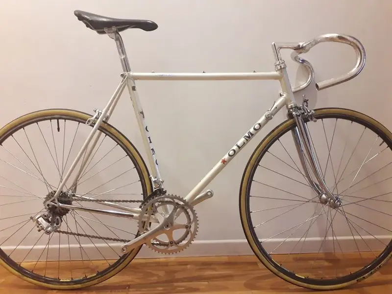

This is the hub and cassette, and the Olmo finishing the restoring process... Group is 91-94, with older cobalto's.

Aha, it looks like you have an 8 speed hub with a 7 speed cassette packed out with an extra spacer, that will make it easier!
You will probably find however that the rear derailleur can only cope with a 26. There were touring and MTB derailleurs back in the day - I have a Campagnolo Icarus on a bike of mine with a 28 sprocket. A short arm Campagnolo MTB derailleur looks very similar to the road ones so can be a good solution for keeping a bike looking right.
That's a nice looking bike by the way :D
