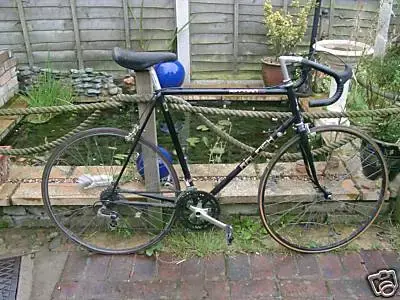

Well, after months of searching, one of my holy grails came up on eBay, and I am now the proud owner of a 1987 Raleigh Record Sprint. (dated from the Weinmann 500 brakes!)
I had hoped it was the slightly earlier version, with the Aerospace Countour tubing, but this will fit the bill for now...
I've previously obtained a NOS set of decals for it (the Aerospace tubing one, but they are identical bar the downtube one, which isn't used on the 87 version) (any ideas where I can get these duplicated?)
Plus a NOS Selle Royal saddle finished in Black Suede effect.
I picked it up this morning, and have now stripped it right back to frame, with only the chain needing removal, plus the crank set...
