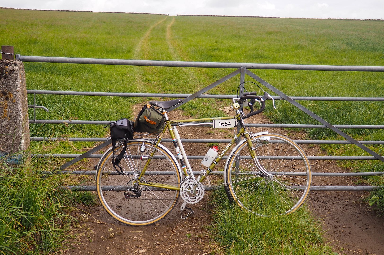

I used a Carlton Corsa at this year's Britannia event in June. Used a 48/38/28 triple up front with a 34 on the back. Changers were both more modern Shimano items, operated by downtube shifters...

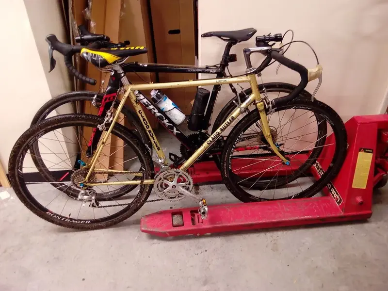

My mudplugging ride to work Claude Butler Majestic is great for climbing hills and is mostly all Campag.
It was put together from bits I had in the parts box so its got a Campag Veloce medium cage rear mech, double front mech that seems to cope well, triple chainset with 53, 42, 32 rings and a Shimano 11,32 cassette and Shimano downtube friction shifters.
With the 35mm knobbly tyres it goes up hill, down hill and through the woods really well and is of course Eroica eligible so I don't think finding parts to do what you want will be that difficult.
