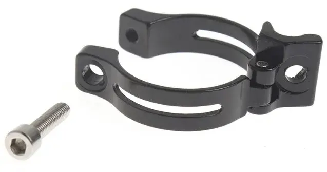

OK so I have a question about braze on clamps for the Raleigh Banana.
I guess I need one to mount the front mech? The mech I am using will be the Shimano Tiagra Front Derailleur 2 x 10 spd.
I did buy a shimano one but I sent it back, firstly it was too big and secondly it was too thick and the location of it would have just covered the bottom of the Raleigh decal hence wanting one that isn't so chunky.
So I need a thin braze on clamp, any ideas what my options are or will any braze on clamp do? I've seen some nice think campag ones but I guess they are not suitable?

Do you need a mech that clamps to the downtube or a mech that bolts to a brazed on tag (on the downtube) ? A braze on clamp is a contradiction in this context.

You only have two choices with the clamp, find another that is 28.6mm and thinner, it really does not make any odds what brand it is as the tabs fitted to frames are all pretty much the same. Your only other option is to get a different front mech with a 28.6mm tube clamp type fitting. Personally I'd go far a different adaptor.

If you want to use the indexing for the front mech, you will have to use the correct model as the shifting wont match the cable pull and reach.
The clamps that are available to use the braze on type mech are quite big and chunky. You could get one and trim it down.
Most band on front mechs now come with frame adaptors for 28.6/ 31.8 and 34.9 tube sizes, but again, you must carefully partner them to your shifters otherwise the front shifting simply wont work.

The two squares stick to the frame,well you only use one. There is a grub screw in the mech that you then screw against the plate to give some extra support. Helps with modern lightweight tat that flexes.

Something like this would be ideal but I wasn't sure if I could get away with it:
Pleased to know I can :D
