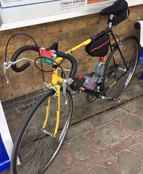

Pleased to hear the banana holds its own out there. Any pics of yours ?
On the way to this years London to Brighton. So full kit onboard
Another, it’s not the lightest but I enjoy riding it. Gone through a winter on it and made sure everything was serviced, cleaned and fettled on an OCD level.
