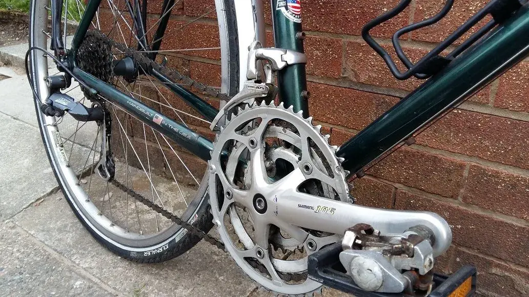

hamster wrote:
Your SPDs with plastic on one side are typically a double sided SPD with a plastic pad that engages in the SPD, probably you can unclip it and reveal a double sided SPD pedal. All the Shimano ones are brilliant: agreed that the 520 is probably the best value one. I get about 5 years out of a set, including a lot of winter riding.
You were right!!!
