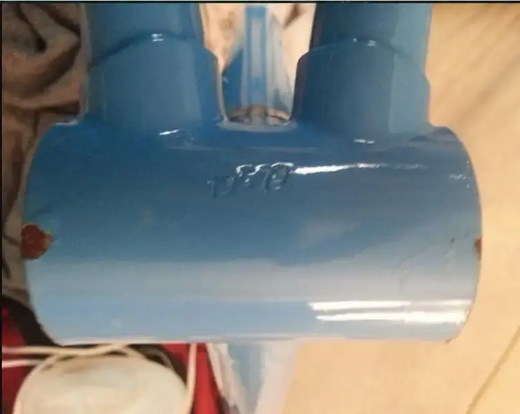

This is a high quality frame with many similarities to high end carlton/Raleigh frame sets but the number doesn't fit. The number is stamped in quite a distinctive place between the rear stays where they meet the bb. Please see the photo. Does anyone know which frame builders did or do not use letters and stamp in this location on the bb? Any help much appreciated. Thanks

Doesn't ring a bell. Any more pics? Raleigh tended to use a plastic under BB guide and not brazed on tunnels?

Thanks for the reply. More photos here https://drive.google.com/drive/folders/ ... sp=sharing
The shop I bought it from said the original owner called it his Carlton. It came with a Campagnolo record headset and gear levers attached. I believe the rear drop outs are 80s Campagnolo??

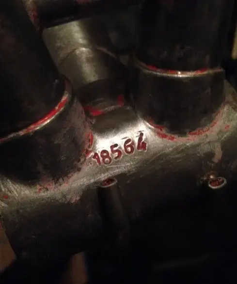

The only well known builder I could find that doesn't use letters is Bob jackson and there is one pic online of a Bob Jackson bb stamped near the centre of the rear stays position but the digits were bigger. Please see picture

Carlton would have the typical W for Worksop number if 80's......even if it was made in Nottingham.

Yep, this one has me stumped but the only thing to go on is the positioning of the serial which is quite deliberately placed centrally in between the rear stays.

Any pics of the seat stay cluster, lugs, dropouts etc? By 80's dropout did you mean for the Portacatena. I guess the shell is 68mm standard UK

Number is certainly consistent with mid '80s Bob Jackson, (and rules out several other builders). The brazed on cable guides might've forced the stamper away from a less consticted location.
There's some frame no. pics on this page, confirmed by BJ as an '86, I guess making yours (if BJ) late '85 or '86 too:
http://www.retrobike.co.uk/forum/viewto ... p;t=373612
