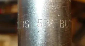

If you're lucky the type of tubing might be fainting stamped somewhere on the frame - If you're really lucky it might be on the steerer tube. I have a mystery French frame that I looked over very closely using a torch and was able to see VITUS 172 stamped very lightly near the lugs on the three main tubes. I've not checked my Reynolds 531c Raleigh but I found these examples online:
