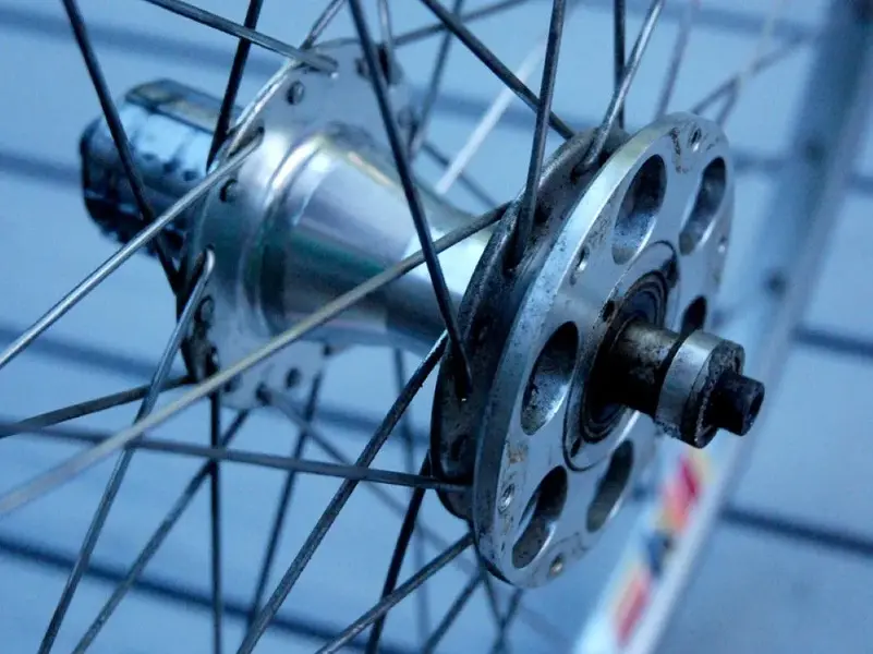

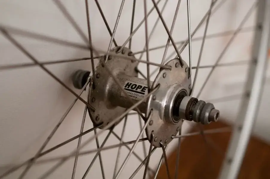

I may be able to help you here
Hope did tandem hubs a bit back. I've a new pair of Large flange 36h,which i believe its the same axle that the ti glide uses :? and i think ive also got a 130mm in that
I've not fitted a front axle but i think its the same with the rear and a suspension would fit.
Both are Disc versions.
Piccy from web as example. Currently in shell form, im still farting about with them.
