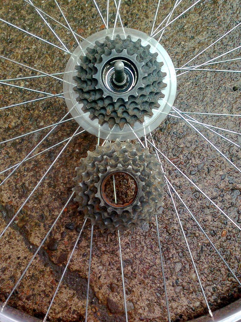

I bought the cassette along with the wheels at the beginning of last month. I had a problem with the chain skipping in fourth (and sometimes ninth) gear when I pedalled hard, which I presumed was down to the (probably original) chain, rather than the new cassette. This is why I started this thread.
However, the free-wheel mechanism jammed up on Tuesday when I was out for a ride. I took it apart and found that one of the (tiny) bearings at the 'front' end had split in two. So I dug out the old wheel, had to go round to my LBS to get them to remove the old cassette, which I fitted to the new wheel.
Here's a pic of the old cassette on the wheel just after I fitted it, with the new cassette beneath:

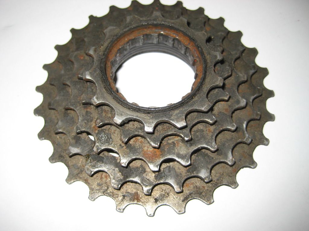

Here's a close-up pic of the new cassette:
It's hard to believe that it's only a month old. I've done a few hundred miles on it, but as far as I recall it's only been out in the rain once, so I don't know how it got so rusty inside. The bearings were also starting to rust, including the one that split. Looking closely at the state of the fourth gear teeth, it's not hard to see why it was skipping!
It now works much better with the old cassette, than it ever has with the new one. I can hear the change in pitch of the rattle from the chain, as I move the lever to change gear, and when it changes it does so with a nice "clunk." No hint of skipping either, no matter how hard I pedal.
I'm now hesitant to replace the chain with a modern one, my main concern being that I'll have to grind the old chain off so want to make sure that I have a suitable replacement before I do so. The old cassette seems solid enough, and in the interests of keeping the bike "retro" I am currently planning on sticking with it. So for the meantime, I'll continue my search for a new "old" chain.

Those are freewheels not cassettes, the difference between the two is far from academic or pedantry.
The "new" freewheel is clearly not new: the wear is obvious.
Chains are a consumable item and need to be changed relatively often (dependent on use), compared to the chainrings and freewheel (or cassette).
What do you mean by a new-old chain? A modern (bushless) chain will offer greater service and improved operation over an old-old chain.
