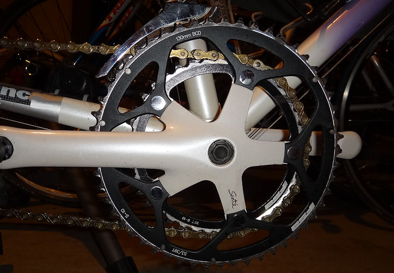

I dont know about street cred but I used 10 speed FSA rings when I went 10 speed on my old 653 Raleigh and Klein. They work great but dont really look period. Stronglight have some more period looking rings that will also work (I bought some from Universal cycles in the US quite a long time ago but sold the bike with those on so no pictures). Not sure they went as small as 38t . Mine is a 39x53 combo.
Sorry for the crappy picture (its dark outside)
