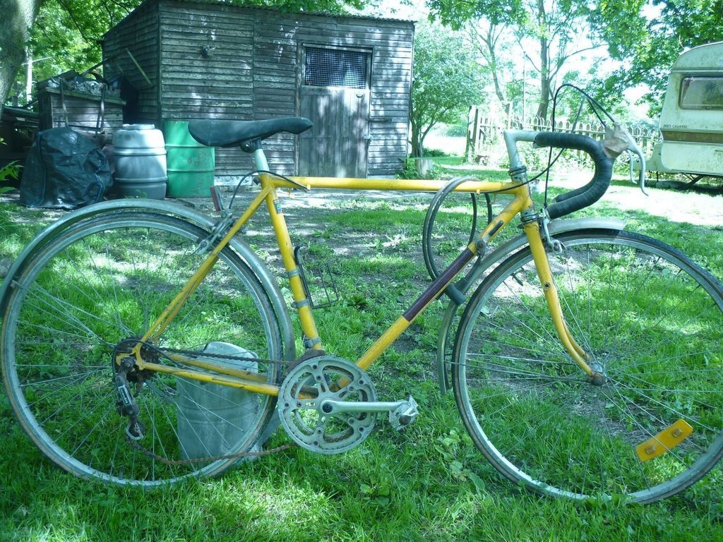

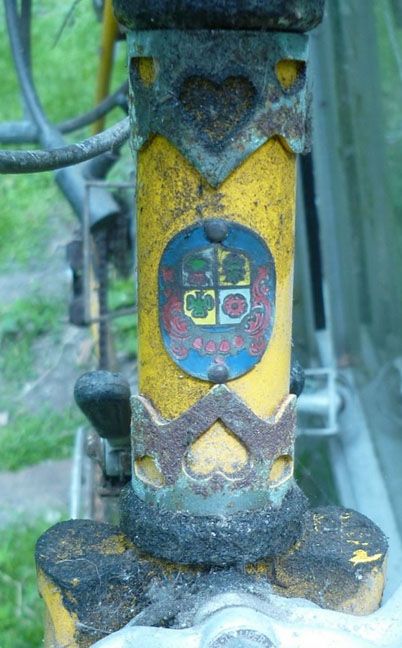

Hello chaps,
I was wondering if anyone can ID this headbadge:
I haven't seen one of these before and it may just be generic as it's a refinished frame but I thought I'd ask if anyone knew either way.

Yeah - those head lugs are pretty ornate and unusual. The frame has a 531 Renovated sticker on it and appears to be pretty light. It's got pressed dropouts (not forged) so that suggests to me that it's either low-rent or sometime pre about 1980. Not a very precise way of dating it, I know.
I think it probably received some of its more modern components at the time of renovation, so there's not much to tell there. I can't discern any serial numbers or other useful markings.

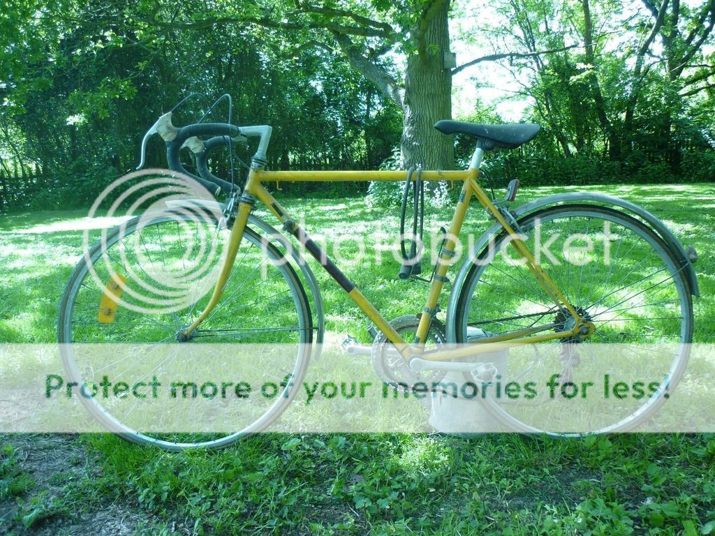

A couple more pics:

Well, I think that clinches it. It's a Dawes Celeste or Star Celeste. Those decorative chromed head-tube rings (they're not actually lugs: the frame is bronze welded) were a patented Dawes feature.
Late sixties to mid seventies. Look for a serial number on the rear dropout.
....to me it looks like a 1950/60's metal Dawes handlebar stem badge (judging by the size) has been riveted onto the head tube when the frame was refinished also it's off centre which I'm sure wouldn't have been the original position
