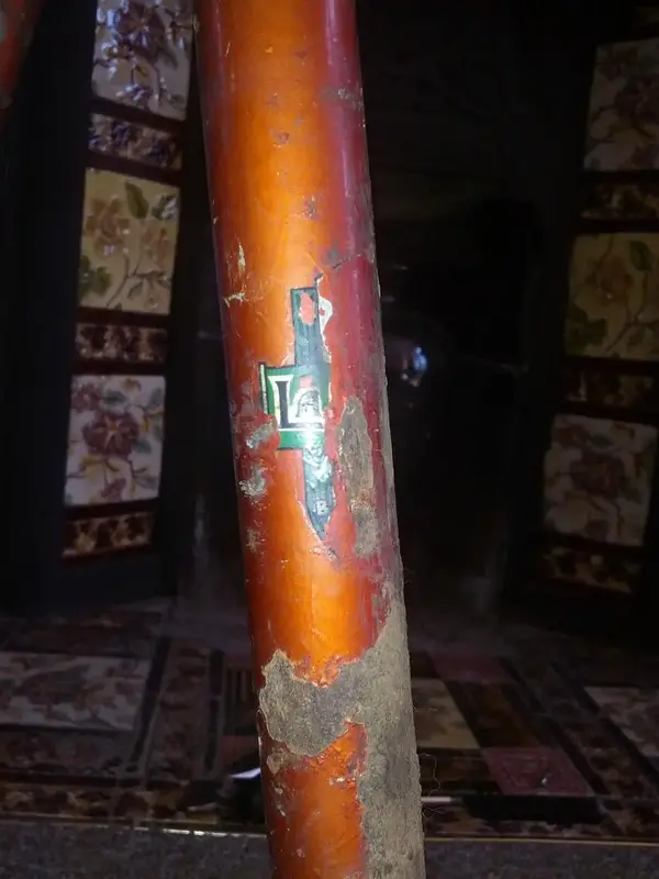

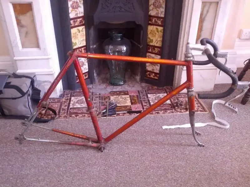

I may have stumbled upon a Queree Brothers Frame, from an unknown epoch. It was pretty well covered (Covered!) in rust when i got it, and after after some extreme sleuthing down at bikeforums dot net, we surmised that it was a La Queree, based on the remains of the label (start with "La", with an é, and with a smaller "B" down below), and the Nervex lugs code.
So, my question is: Can anybody confirm its La Querée, or shed any more details on the approximate ages? And do any of the Queree fans and former owners have pictures of a similar label, so that I can have one made up and restore it with them?
Also, any ideas what sort of components it would have come with? When i got it, it had a circa late 60s Campy Record Front Derailleur attached, but nothing else. I'm trying to rebuild it somewhat correctly, but I also like 175mm crank arms, and in 60s campy, thems is expensive! I'd happily do a stronglight or other equivalent; velobase has been good to get eras, but I'd like to know a rough "quality comparison", if there is one.

Don't know anything that isn't on Classic Lightweights I'm afraid. I see no reason to doubt what you have learnt - they shut up in 1971 so that's as late as it can be. It's a good find for sure!

Is there a frame number and same number on the forks? What's the nerves lug code? Nice looking frame.

The V-CC has a marque specialist for Le Queree.
Simon

La Queree was the mark or name of the company, Queree Brothers built them
I had one in mid 1950s with the name brazed on in large brass letters either side of the top tube.
Nice frame, Nervex pro etc.
This one could be about 1960.
Cant do the acute.

Thanks Keith--it was actually finding this post via google that brought me here to ask the question in the first place! I'm a little surprised that such a seeming well-loved brand, no matter how small, has so few internet-index pages. "GasPipeWarrior" also has commeted on some Queree lurv, making this the far-and-away Queree leader ;-)

The Nervex Lug Code is: 59^3064^022<2>e38
(the "^" are degree signs, and the <2> represents a sub-script, which I don't know how to type here)
According to other folk, this means that The BB shell appears to be a Ref. 3103A, and
Angle B = 59°30' (Down tube angle to seat tube)
Angle C = 64° (Seat tube angle to chainstays)
Bore A2 = 22.2mm or 7/8" (Chainstay diameter)
Center to Center Chainstay Spacing = 38mm
there is also a "136" as a serial number on the drive-side of the bottom bracket, and also a solitary "1" (or maybe an "I") on the non-drive side. I don't see any stamps or codes for the fork though-- where should I be looking?
and Thanks for the V-CC info-- I'll ask them if there is a similar logo.

If you take the fork out. Mind the bearings! :) It could have the same number on the fork stem tube.

Also what bottom bracket and headset have you got? Any makers name or on them? Could help knowing its age.

The BB I got with it was a TDC (Thomas D Cross); not sure about the headset (I see no markings on it), though it seems distinctive insofar as the threaded race at the top has no wrench-spaces; it is just smooth with a knurdled area to tighten it by hand, if that makes sense (It still has a threaded hex-lockring as usual, but does not match the TDC headset on velobase)
Also, under the BB there was a metal sleeve, cut from "Bird Household Lubricant" acting as a BB bearing shield within the shell. Google implies it was from a company, "Oily Bird" which was active in the 60s.
