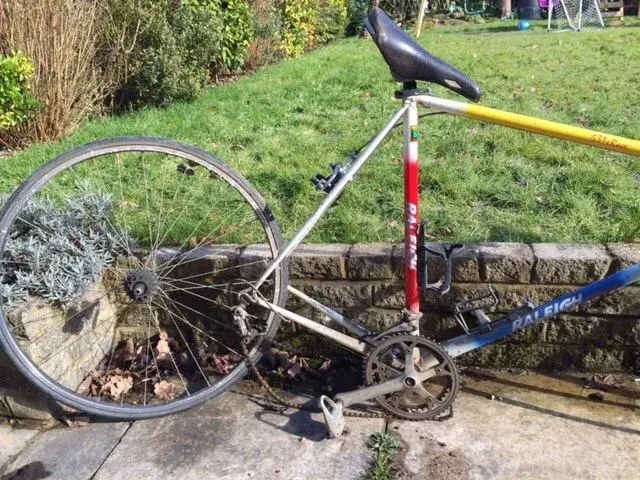

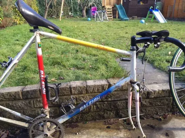

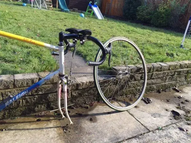

Hi am just about to start looking at restoring this, been stored badly for a while and got flooded which hasn't helped!
Any tips pointers on bits worth upgrading/replacing and any issues with new parts sizes would be welcome
Am going to start by stripping it down and cleaning what i have to see whats salvageable, am really new to this so tips welcome, used to love riding this.
Mavic rims and hubs look in a bad way, rest seems to be a mix of shimano and campagnolo bits

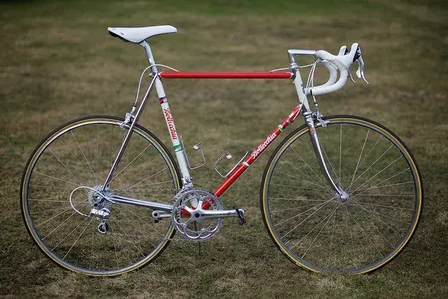

Not much has changed! Rear spacing is slightly wider but won't be a problem, as long as you get a british bottom bracket it'll fit, you can get adjusters that replace the down tube shifters, will work a treat. Here's a retro mod build.
Cool thanks, that looks lovely not sure I will get that finish

Started cleaning it up today, most of it looks ok once you get the crud off
Small crack in the frame at the top of the seat tube though :( turns out it got bit abused since I last had it
