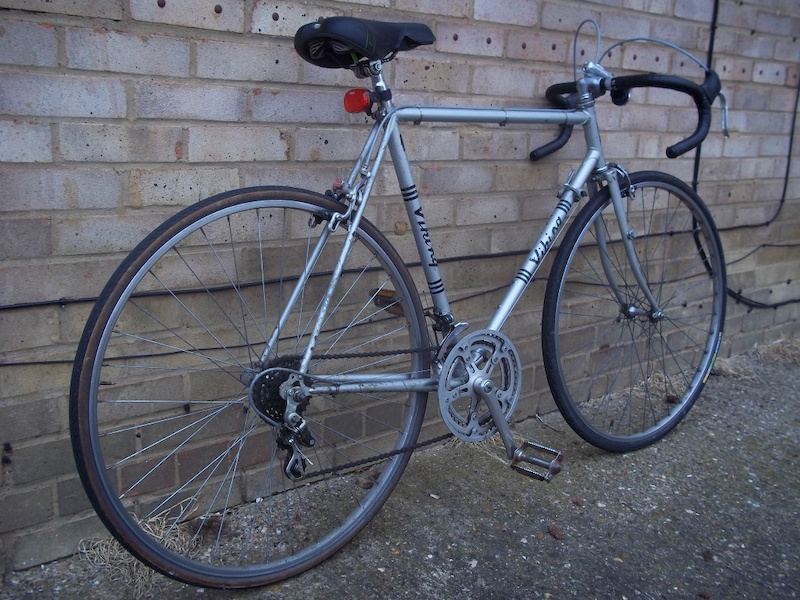

While trying to find a picture of a frame with the same logo as mine, I found this:
This is exactly the same as my 'new' bike. Except for different pedals and maybe that mine has less skinny tyres. But otherwise seat, groupset, etc. looks identical. This might make it a 1979 Viking Vision. If so, earlier than I guessed. Edit: I think the cranks are different. Mine have a 'solida' (or similar, slightly worn away) logo.

Edit2: The ex-owner of the silver Viking Vision above is on here too, and sold the bike. The head badge on his/her bike is the same as mine:
viewtopic.php?t=186093
I reckon that's one of the later NI ones, definitely not a 'proper' Wolverhampton one.

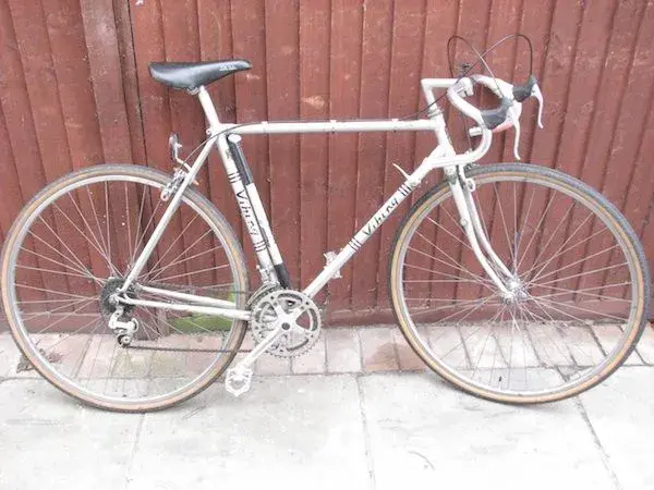

As asked, I attach a photo here.

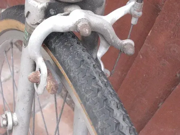

My question is about the brakes. What brake blocks will I be able to use with these brakes. I presume these generic blocks would do:
http://www.ebay.co.uk/itm/2-Pairs-of-Cy ... 51b0e3e294
But, I'd be prepared to spend a bit more to get better stopping power. What would be good brake blocks to use?

I used to have a Vision like the purple one linked above. The braking was poor. Switching to modern levers and cables with Aztec brake blocks transformed it. The old callipers are hard to replace as the drop is quite large - much more than most available today.

The bike has had a service today, as a cycle charity had a drop in repair shop, and I took it along. The brakes were adjusted, and they do work better. Not wonderfully well, but better. So, upgrading the brake blocks is still a priority.
This bike is meant to be a cheap interim bike until I get something better. It makes sense for me to upgrade things that I can or still will use on a future bike, e.g. I'm planning to put SPD-SL pedals on it. It makes sense to buy better consumables such as brake blocks, tyres, tubes, etc. But, upgrading the levers or calipers is a bit more difficult to justify.
Under the grime, that looks like a pretty nice bike. Viking were pretty poor at differentiating their models (or they were good at making their cheaper models look like the more expensive ones, depending on which way you look at it...). But if yours has 531 tubing and fairly high quality components then you'll be pleasantly surprised at the drubbings you'll be able to dole out to blokes riding much more modern machinery.
Fibrax do direct replacement brake blocks http://www.fibrax.com/rim-pads/road/com ... tic-blocks.

Could you post a couple of close ups of the seat post and the drop outs that hold the rear wheel?
