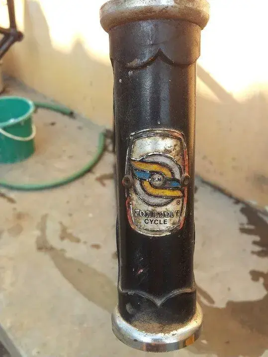

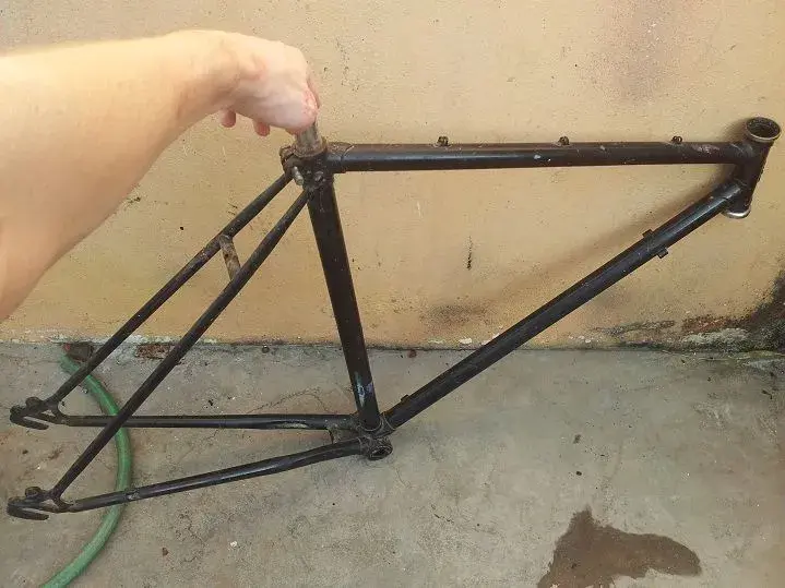

hey all,
so i just got this frame from the local bikesmiff who lives down road from me (in thailand) i mentioned to him that i was interested in building a road bike, then he ushered me downt he back of the work shop and pointed out a frame to me.
it looked pretty cool and kinda retro and wasnt too heavey. so i took it.
he told me it was a famous brand and it was rare, from what i could gather (im still beginner level speaker).
so what i know already:
its black , under that was blue.
it was made in taiwan (yet to be confirmed)
head badge on it says 'foremost' - after googling this i got all kinds of crazy conflicting results
it's roughly 25 years old. thats all i know- if any one can give me any more info on this brand its history- and its quality or value ( if any) that'd be swell.
id love a picture of an original complete so i know what the hell it is im rebuilding. he did mention he had forks for it too, im not sure if they're the originals or not, i hope so.
cheers folks!

PostPosted: Wed Nov 06, 2013 7:42 pm
Joined: Tue Jul 17, 2012 4:41 pm
Posts: 444
Location: Moneyscalp N.Ireland
JC Penny sold bikes named Foremost they were mainly utility/cruiser Schwinn style bikes and built in Jackson, Mississippi......possibly the same company?
PostPosted: Wed Nov 06, 2013 7:59 pm
Joined: Tue Oct 09, 2007 1:55 pm
Posts: 8798
Location: New Forest, UK
Possibly a pun on Taiwan being historically called Formosa?
PostPosted: Thu Nov 07, 2013 4:00 pm
Joined: Mon Mar 26, 2012 5:21 pm
Posts: 635
Never heard of Foremost, not that that means anything.
Things that can give an idea of the quality of a bike:
- rear brake bridge: the "tube with a hole" that you have is typical of lower end bikes.
- dropouts: pressed (stamped from sheet steel, with "sharp" edges) being lower end and forged being higher. Are they named?
- seat tube/post diameter: 27.2mm/27.0mm being top end; being smaller doesn't necessarily mean it's low-grade steel as, for example, 531 came in many different flavours and seat tube sizes.
- lugs: they don't look to have been finished with any particular care.
Mudguard mounts won't be found on a thoroughbred race machine, but there are also plenty of good bikes which have mudguards.
The rear derailleur cablestop is on top of the chainstay which is the "old" position; but it has braze-ons for downtube shifters and toptube cable guides which were "later" features. Different manufacturers were using these features at different times and there is no precise cut-off date, but I'd hazard a guess at late Seventies/early Eighties.
