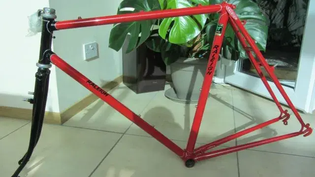

I recently won this repainted Raleigh (see attached pic) from eBay; the paint layer on the BB shell underside is a wee bit thick so I can't make out the frame number. However, it has double bottle bosses, rear rack mounts and a sloping crown often found on mid 80s-early 90s 531 Raleighs, whilst the seat stay caps have the serif all-caps "RALEIGH" embossed detail, so is fairly modern (the BB is designed to take a plastic gear cable guide plate too) in relative terms; to sum up, a lot of the little details seem common to my ca.1989/1990 Quadra II. Any ideas as to possible model? It has horizontal not vertical rear ends with single guard/rack eyes which seems to rule out one of these....
viewtopic.php?f=22&t=252157
....as well as the Royal or Randonneur. Interestingly, unlike all 3 of those models it's designed for bar-end levers only as there are no down-tube bosses, just brazed on head-tube gear cable guides of a pre-Ergopower type, much like an old-school CX machine....but it's clearly built for touring so isn't a CX bike of any sort! Front fork and rear frame dropouts are all stamped "RALEIGH" with screw adjusters on the horizontal rear ends. :?
Done a bit more digging - could well be a Gemini 18 hybrid??
David

I believe Raleigh also made touring bikes for a number of different shops, I believe there was a batch made for F.W. Evans along with several other shops who BITD specialised in such things, the fork crown looks very much like the one on my Evans. Get it built up and ridden, if its 531st it will be a nice bike to ride all day every day.

Looks similar to this,apart from the down tube braze ons
http://www.flickr.com/photos/74418119@N ... 4675787816
G o'D designed frame , built in Nottingham SBU.

Not one of those, they had vertical dropouts with separate rack/guard eyes. Everything seems to be pointing towards it being a Gemini so far (with hindsight, Raleigh were quite forward-looking as far as the concept of the "hybrid" goes). Looking forward to getting it built up, though - never owned a proper touring bike as such before and the prospect of heading off on a few mini-adventures next summer* is very appealing.

The frame as originally turned out at Nottingham would have looked like this:
Surprising the difference a coat of paint can make. I'm wondering if the previous owner was going for a 70s/80s TI team issue style of colour scheme (sort of).
