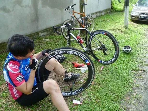

Wasn't sure which section to put this, but it's a road story so here we go..
Yesterday, crack of dawn, met up with my roadie friend intending to enjoy a nice road ride. After 7km roadie got a flat.
1st attempt: Tried a Topeak stick on patch, just to try them out. = Flat tyre (can’t handle the pressure).
2nd attempt: Fitted friend’s new spare tube. Comes with installation piece to extend the valve for deep carbon rim but friend’s pump wouldn’t fit over his larger diameter extention! Used my mini pump. = Flat tyre (pinched new tube with tyre lever).
3rd Attempt: Hmm two knackered tubes! Patched the spare tube and tried lower pressure = Flat tyre (air leak at the extension piece, try as we might, not fixable).
4th Attempt: Back to original tube, only 4 patches of dubious effectiveness left so we used all 4 patches to reinforce the sealed area, bound with insulation tape robbed from a light fitting. = Flat tyre.

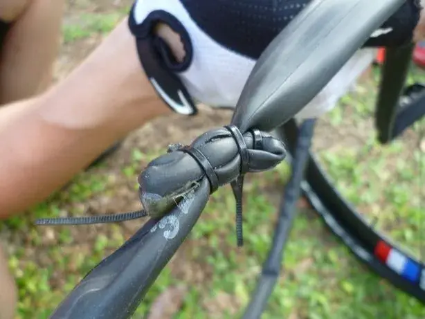

5th Attempt: 4 cable ties robbed from computer mount, zipped each side of the puncture then zipped again into S-shape. = Success! Bike can be ridden normally with the repair scarcely noticeable.
After 20 mins of riding and 1+ hour of fixing we rode to a cycle shop and while the bike got new Continental tubes with decent long valves, we went for fried noodles.
Lessons learned:
a) Make sure the tools/pump/spare tubes fit the bike!
b) Stick on patches are useless compared with the good old [and effective] vulcanizing patches with glue, chalk and a little bit of sandpaper. Of course patches are anyway a second chance emergency but if you’re carrying any they’d might as well work.
c) Carry a few small cable ties. They weigh nothing and make a superb emergency puncture fix.
d) Never give up!

i am sure you must have felt that huge lump of inner tube and cable tie going around inside your tyre?

Live and learn right. I use Parktool stick on patches and they are very good; you still need to use sandpaper and make sure the area is completely dry and dust free first. You can do an overhand loop knot (http://en.wikipedia.org/wiki/Overhand_loop) in the innertube at the puncture area so no need for zip ties.

Hi Montello, tried with thumbs but couldn't, we must be wimps, or is there a special technique? Hi Matthew71, not my bike so i didn't ride it at speed but did a few meters test and at low speed couldn't even feel it, the 'huge' lump is less volumous than an inflated tube so maybe not as hideous as it looks, no doubt balance issues at speed but we just ambled back to town on flat roads. It got us home and saved a walk. Thanks for the tip Woz, hoping never to need it though :wink: Hi Ian, true, but one cannot fully know the competence of someone before riding with them, he had tube, patches, pump, tools etc, it's just one of those things. We had a laugh over it but didn't get many kms done that day. I might scrutineer his kit next time though!
