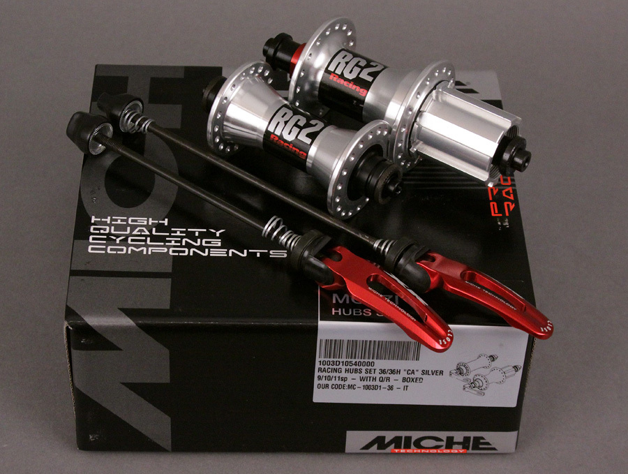

Okey, I´ll do photos and explain throughout the process then. I still need a few bits before I can get started, but I´ll share what the wheels consist of, and why I chose it. these are modern wheels for my 2004 Pinarello Prince SL, I hope you don´t mind. Rims are Ambrosio Excellight, 28 hole front and 32 hole rear, hubs are Miche box racing. Spokes are Sapim Laser double butted 2-1.5-2mm, these wheels need to support my ample body (88kg) Front wheel and nondrive side will be laced with Sapim polyax Aluminum 14mm Nipples, drive side with Polyax 14mm brass. Front will be laced radial, a 28 hole rim is at the edge of hole count where this can be done without failure of the hub flange, rear will be laced 1 cross nondrive side and 2 cross drive side, this because you again can´t lace Radial on a 32 hole hub. As always when I build a wheel I´ll be using DT Swiss Proline Spoke Washers, and as extra bonus (both for me and hopefully you) I´ll be tying and soldering the spokes on both sides of the rear wheel.

A word about the hubs I´ll be using, The Miche company has a 90 year history of production of mainly drivetrain components, they do make nice hubs at a cheap price range however, the hubs are drilled with 2.5mm holes so washers must be used, otherwise they are prone to failure do to spoke stress.
