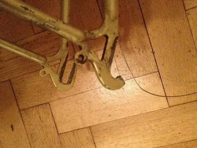

Does anyone out there in London/Kent have an interest in bringing a frame back from the dead? And the skills/equipment to braze?
I have a poor Claud Bulter frame with a broken dropout, can't bring myself to throw it away.
Not looking for a professional job, the frame is worth less than the fix cost, just someone that can have a go!
(Obviously I would pay all costs and will throw in a crate of beers or a bit of cash for your trouble)
Anyone?

Picture of the dropout ? ...........beefy dropouts can be welded I guess.

It's not pretty. How does welding compare to brazing? I would imagine it's a more common skill?

If you still have the other bit your local welder / blacksmith type person would probably repair it pretty cheap..

I do but unfortunately it's very bent.

Beat it flat and it will mig straight on.

Steel dropouts can take a lot of abuse......as can steel frames :)
Make sure afterward you carry out NDT Dye Pen on the weld or have it MPI'ed to complete the job fully for piece of mind if going down the welding route.....
had a similar mishap awhile ago but successfully reshaped in a bench vice....just squeeze the jaws tight

I'll supply a nice pair of forged dropouts for that, karma, if you need.
Always best to replace both if you don't have a perfect match. Any repair of the existing will put a weak join at the point of highest stress, not a good idea.
The old ones will pull out easily enough from the domed stay ends. Clean up and replace.
