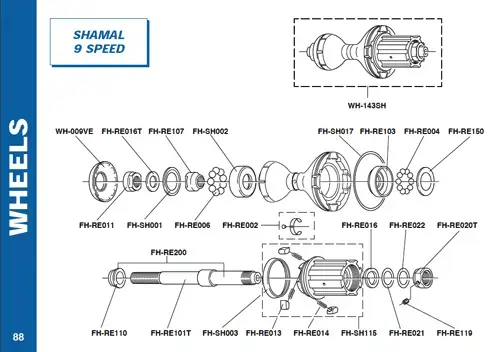

From Memory if its an 8 speed Shamal with normal elbow type Spokes then it should be the same as a C-record 8 speed 32/36 hole cassette hub. But the 9 speed shamal used straight pull spokes & the hub is different. Strip the hub right down & evenly warm up the body of the hub (i use a electric paint stripper gun) on the side you want to change & tap out the cup Keep the body warmed up & refit the new cup (make sure its as cold as possible) so body hot cup cold just makes it easier to fit.
hope this helps.

Thanks heaps!!! Yes, its RE005 that I'm after. Thanks.
