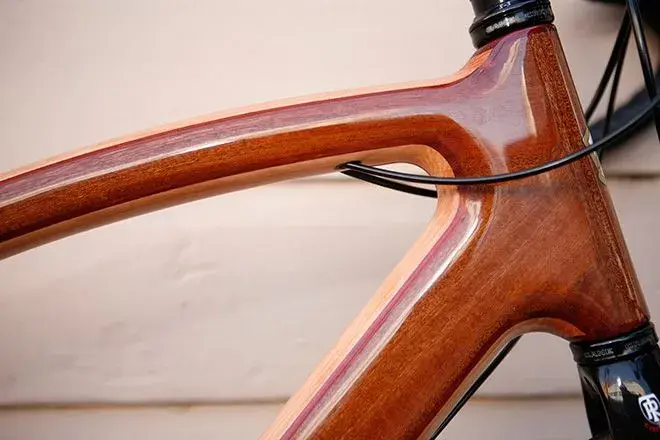

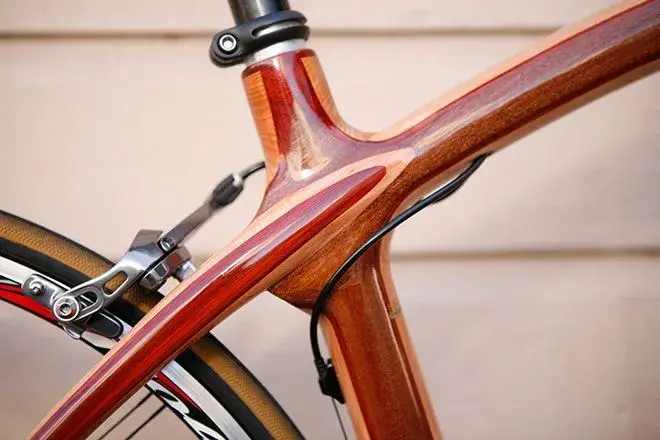

Very good.
But I had a tree fall down in the garden and I whittled this out of it.....
:lol:
