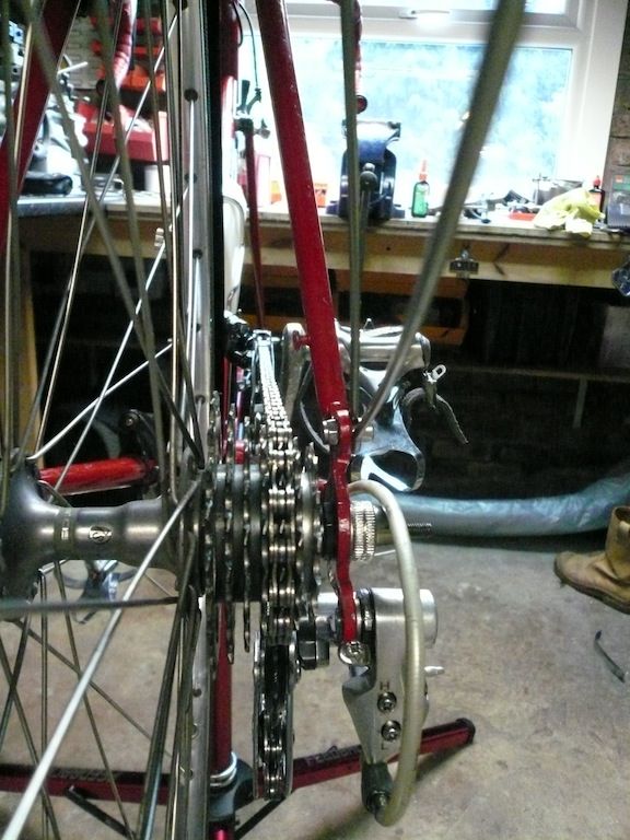

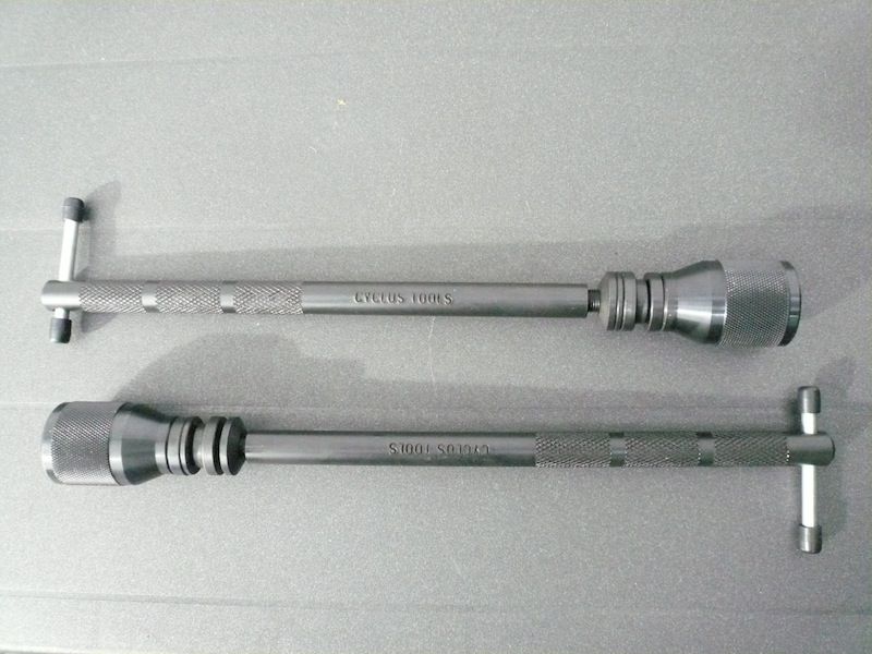

Ever since my daughter keeled over on the Peugeot earlier this year (blame the clipless pedals) the gear changes have not been the same. I tried a few times to rectify the problem but the SIS gear changes were never quite as crisp as they used to be so I decided that apart from a buckled wheel which I had repaired, something must have gotten bent.
I decided to purchase a couple of tools to assist in my plight for perfectly smooth Shimano 105'ness gear changes

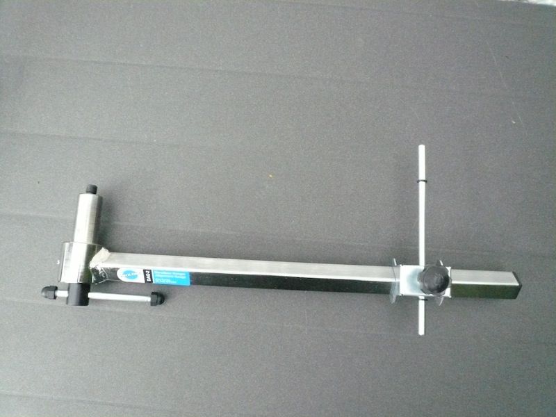

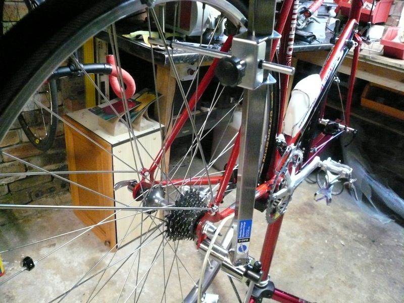

Firstly I bought a Park Tools derailleur hanger alignment gauge (DAG-2), this was set up and showed the hanger to be out by quite a bit, so after resetting the hanger things improved but it still wasn't perfect

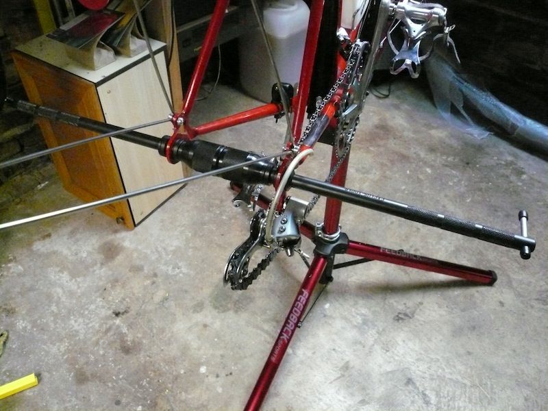

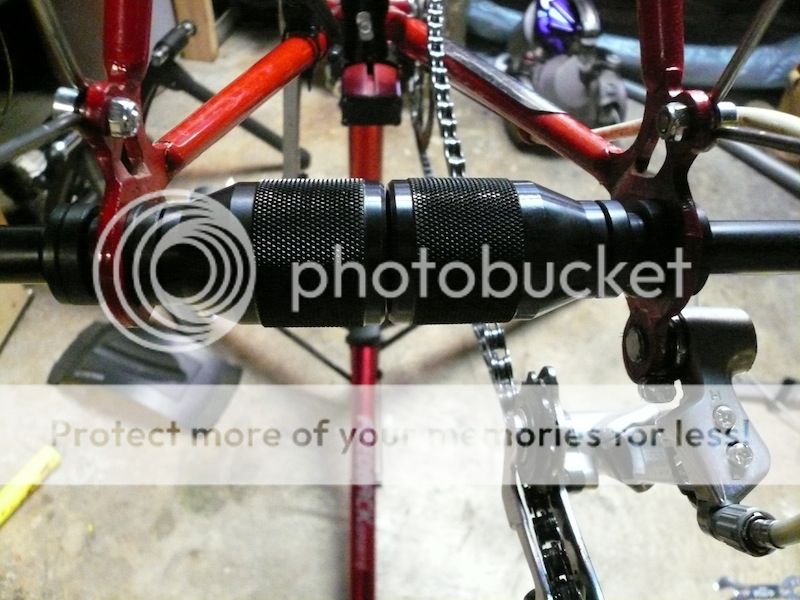

I then bought a Cyclus Drop Out Alignment tool (less than half the price of the equivalent Park Tools FFG-2)
So this morning I set up the Cyclus and it showed the rear dropouts were indeed out by a few mm, after a bit of frame bending it was looking much better

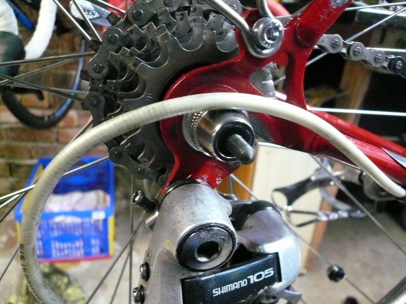

So I refitted the wheel and reset the hanger again
I adjusted the derailleur and it is now working as it should, so I will have the Peugeot for a while longer

You will be gutted if you ever try the Drop out tools on a modern carbon frame, they are never in line. A while back I did that to a McLaren Venge from specialized, 5mm out of alignment...

Now I am intrigued, can a modern carbon frame actually be realigned in the same way ? I assume not , or am I wrong ?
PostPosted: Sat Oct 19, 2013 11:06 pm
Joined: Fri Oct 14, 2011 8:41 pm
Posts: 9217
Location: Cumbria
Not as far as I am aware.........how it comes out of the oven, that's it !

So to carry out the checks and modification - both tools are required - and in your case, the hanger was out of alignment, as were the dropouts. Does the Park tool adjust the hanger alignment? How did you 'reset' it?
And a further nosey question - can the dropout alignment tool be used to increase/decrease rear spacing ie spread 126mm to 130mm etc?
