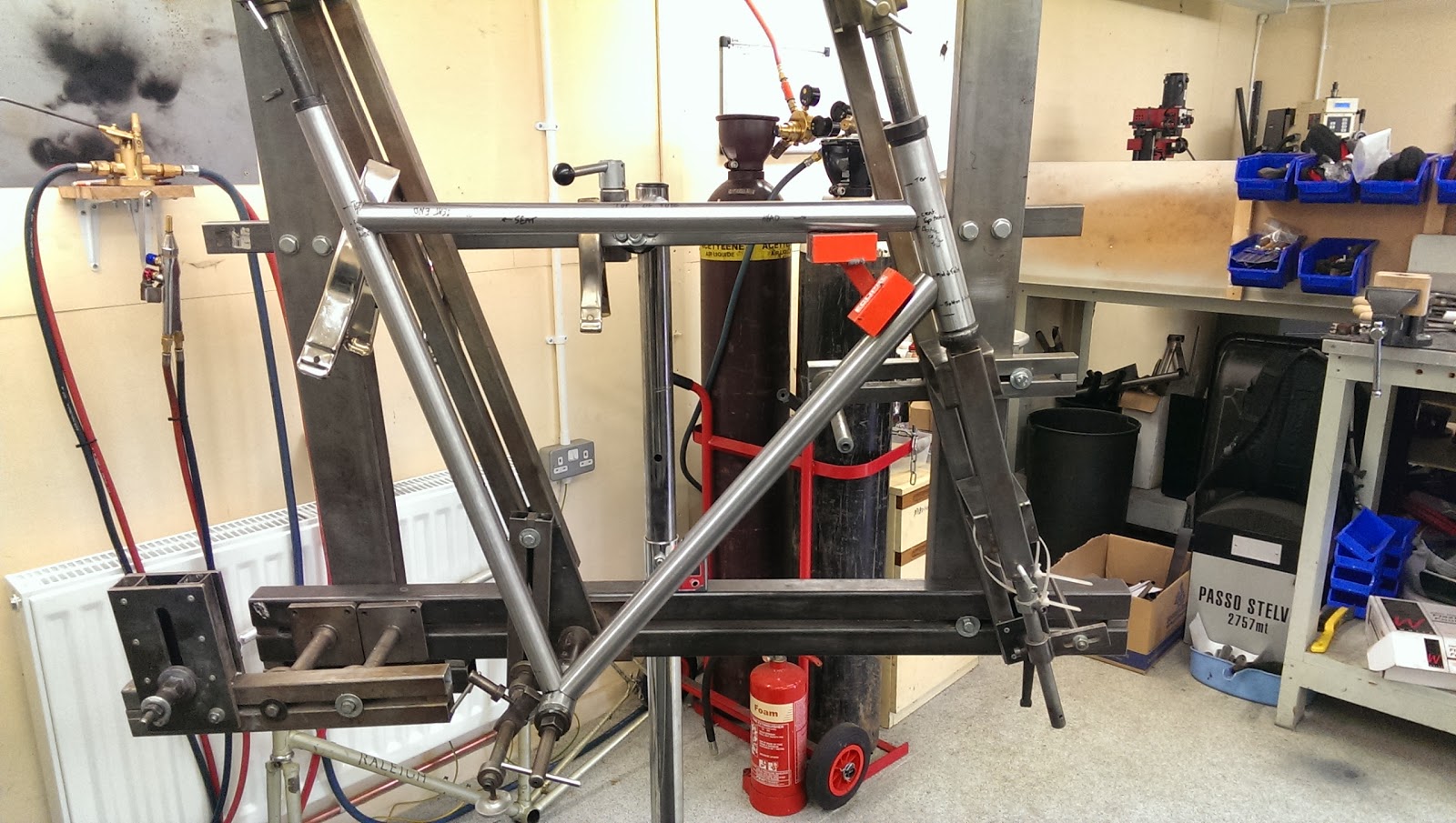

Getting alignment correct is pretty simple - mark centrelines on all your tubes, cut the mitres central to those lines and then set it all up in a jig to get everything lined up. The jig has a static boss for the bottom bracket lug/tube and then the bosses for the seat and head tube are adjustable for angle but only in one plane - they always keep in line with the bottom bracket.
Then the only thing that can go wrong is if the tubes move when you braze/weld them together, but there are clamps to prevent that from happening...

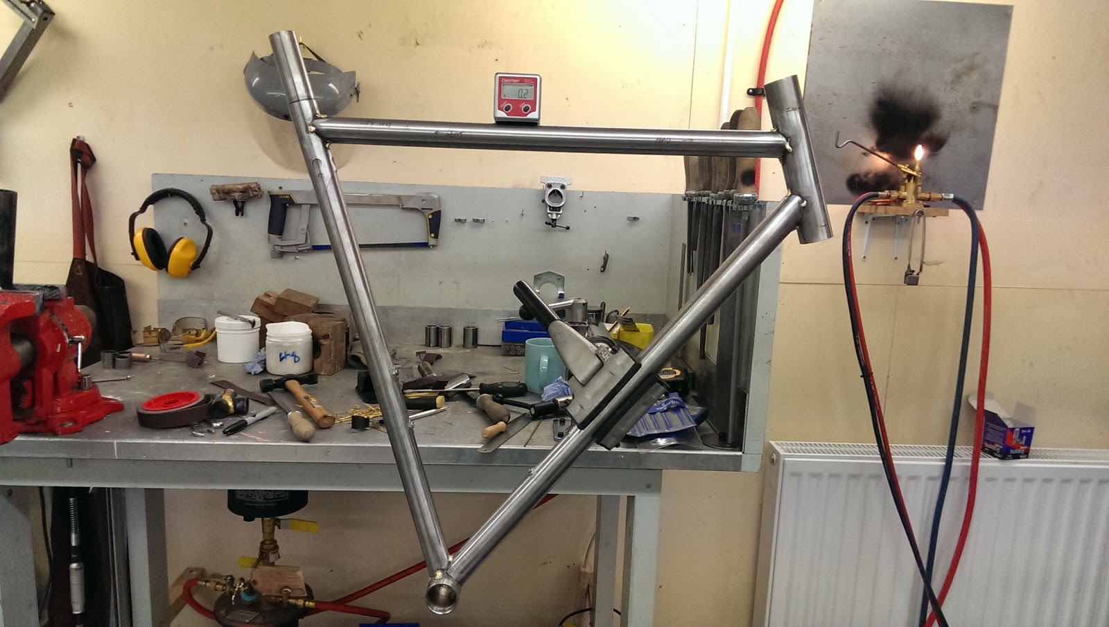

Ha - thankfully there were no fires today, and even better, no holes through any Reynolds tubing which shouldn't be there!
I tacked and then fillet brazed the tubes together this morning and the brazed my seatpost sleeve on this afternoon. Tomorrow we're setting up the rear triangle and carrying on with the immense amount of filing that needs to be completed!
Tacked together:

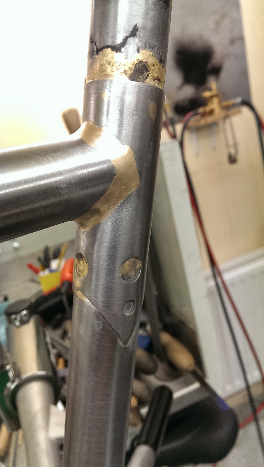

The Seat tube to top tube joint brazed and filed down:

Do you get to paint it as well?
Just out of curiosity, there's a hole in the brazing. Does that get filled in with more brass?

augh i see that makes perfect sense, the verticle line in relation to head tube and seat tube are identicle. top tube and down tube simply connect.[then how come ribble had far less appraisals than cannondale ? ha lol ]
I must say that jig looks a nifty bit of tool making, functional not too expensive but an absolute must of course the finer the tolerances with that baby, the better the frame ! forks are prob straight forward when you know how.eh! tell me, is this an all out business venture ? or part time venture ?
