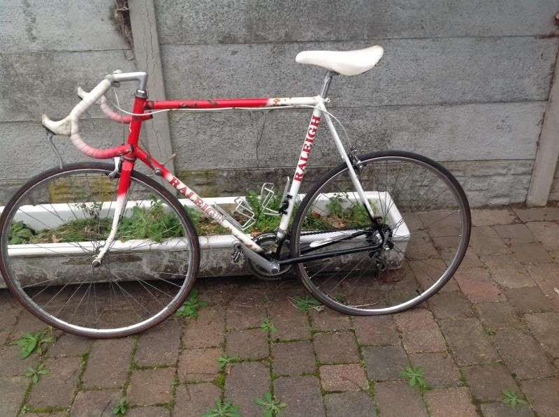

Hi there i have just picked up a Raleigh corsa from which I hope to reprint etc . My question is are the decals /stickers still available, has any one managed to remove the Raleigh badge successfully and re use it later.

hi the Raleigh badge is on the head stock and appears to be glued on as there are no raised rivets as I have seen before.

Can we see some pics of the Corsa?

Here's a pic of caveman720's Corsa:
