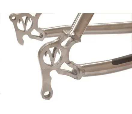

....well for one, a Ti frame would pretty much require a Ti drop-out.
Sure enough they all serve the same purpose to essentially secure the wheels in their proper place, but it's like anything else where there are variations in strength, weight, aesthetics and cost to play with. Campagnolo drop-outs is largely a sign of a quality frame and not too shoddy.
