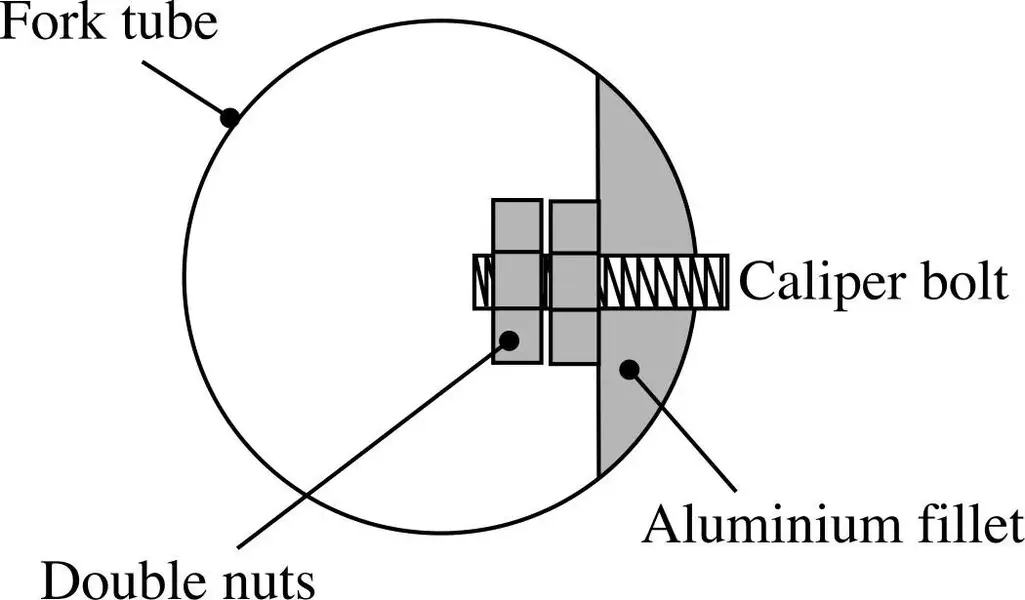

I think I can see your dilemma. I'm not sure I would trust adapting the rear brake to make the front, the front being the most important. Maybe if you filed down a piece of aluminium to match the curvature of the inside of the fork tube, then double nut it.
Like this:
That may give a solid fix.
