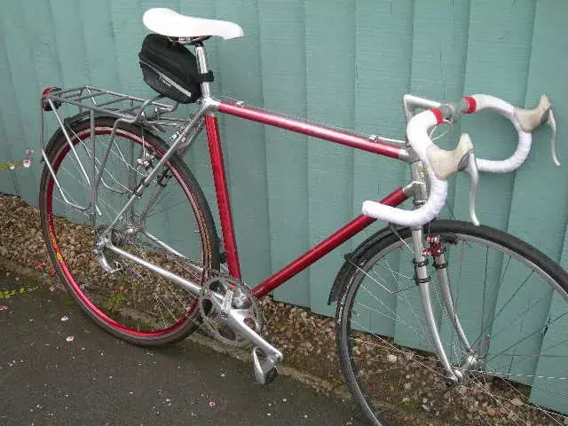

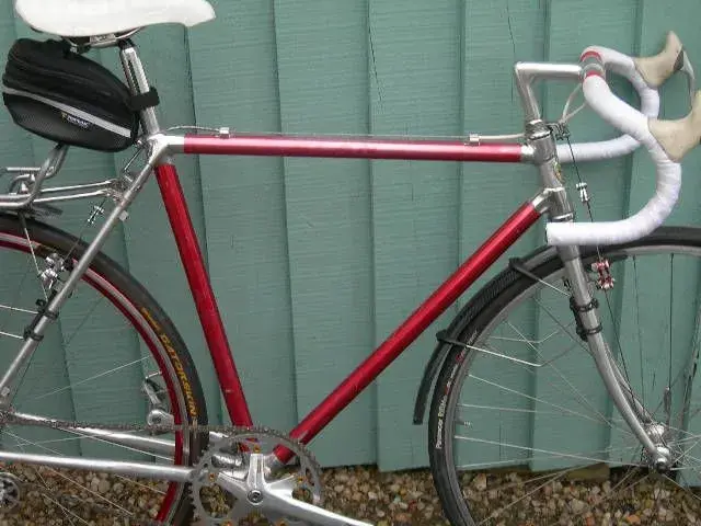

Go for it!!;Classic frame
I commute on a '95 model fitted with the original alloy forks.
Correct in that they were screwed & glued.I have experienced no issues with flex as the cast bb has thick flanges.
It really is a do-it-all frame as you can fit tyres up to 32/35c for winter bombproofness or narrower for racing.
Cantilever brakes are also superior for stopping ( I fitted frogglegs)
I've even got a (removable) rear rack & mudguards fitted!
Good luck
