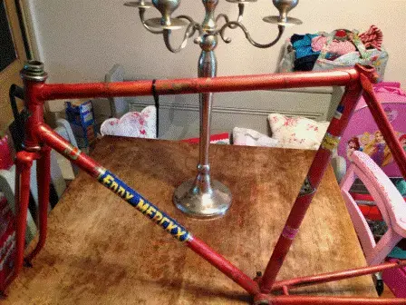

I'm new to the forum and I was hoping somebody would be able to help me!
File comment: Eddy Merckx frame
I've just brought an Eddy Merckx frame with a vire to restoring it, but wanted to know a little more about the frame before starting out. I've read lots of articles about a serial number of the bb casing but cant find one on this frame. Any advise would be greatly appreciated.
regards
Tony

Without some detailed pictures it looks like the frame from a cheap british made bike from the early 1960's branded Eddy Merckx. Can't remember if this was another of the Clements efforts.

Thanks for the response, what pictures would help identify? Is it not a genuine merckx frame? The guy who sold it described it as a French frame...

If French it would have right hand thread both sides of the bottom bracket.
Close up sharp pictures of the head set and lugs, bottom bracket, seat lug, fork crown and fork ends.
If you can accurately measure diameter of the seat pin it gives us an idea of the gauge of tubing. 25.4mm would be heavy cheap tube, 27.2 would be quality butted tube.
Any names stamped into the headset and bracket cups?

Falcon Cycles (Frank Clements again) had a licence to produce Eddy Merckx branded bikes in the 70's. There were several cheap ones in the range along with some better ones but I've ever only seen the cheap ones - like this.

Rumour had it that Eddy was horrified when he turned up at the Falcon factory in Brigg/Barton for a promotion. He couldn't believe the poor quality of bikes bearing his name. The contract didn't get renewed. The perpetrators of this deception? of course paint a different picture.
Sorry Tonym, yours looks like a 1970's Falcon.

As above really, we used to sell them in our shop back in the mid 70's. We never came across the Campag Equipped ones though........
Is there anything on the other decals, the name of the shop that sold it?

The bike has various stickers on it. A couple are french, and the one on the downtube says Durifort made in francaise and the seat tube also has a Fabrication francaise sticker on it. As I said before the frame has been poorly painted by hand so I'm thinking of stripping it back to bare frame and respraying it. Would it be worth doing that?

As above, it does look like one of the cheaper Falcon ones so not sure it would be worth time, effort and cost of a respray and rebuild.

I am sorry to say this is hardly worth restoring. A Kessels made Merckx would be, but this certainly isn't. Probably a Falcon.
