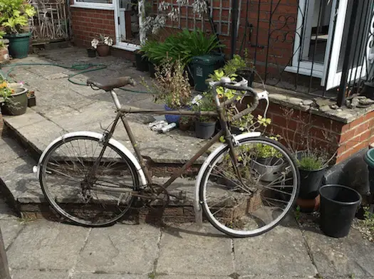

Hi
I am currently in the process of putting my late father's bike back onto the road. It is built around a Claud Butler frame bought around 1946/47. The chassis number is hard to read but it looks like 062564...the first number looks like a 0 but its hard to see. It is a 27" frame with 26" wheels. The majority of the bike is original with only the tyres, spokes. brake handles(i have one original) and mud flaps.
Question: can the frame be dated from the number?
Question:is it best to leave the original but very well worn paintwork or send it to be resprayed?
There are photos on Flickr:http://www.flickr.com/photos/23634022@N02/
I will post some on here when my partner brings me her low resolution camera
Thanks
Ian

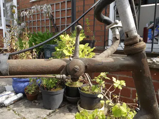

Hi Terry Finally cleaned up the area and the actual chassis number is
862564
Does this help to date it
Ian

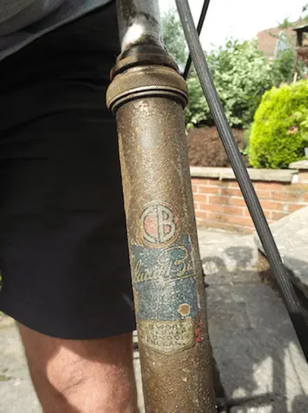

PostPosted: Mon Sep 23, 2013 6:03 pm
rBoTM Winner
rBoTM Winner
Joined: Tue Aug 26, 2008 7:48 pm
Posts: 521
Location: N. Herts
Hi Ian,
the serial number means it its a June 48, or June 38, so we need other clues, generally pre war headstocks would be clip type, but there were standard steel headsets available. So, its looking post war, the mudguard treatment looks post war ( no tabs ), so 1948 looks valid, and in the 1948 catalogue there's an international club, and that looks a possible, worth doing some internet searches for other examples. I hope this helps, have you cleaned it, and gently polished it yet, to see what it comes up like. Terry

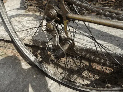

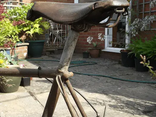

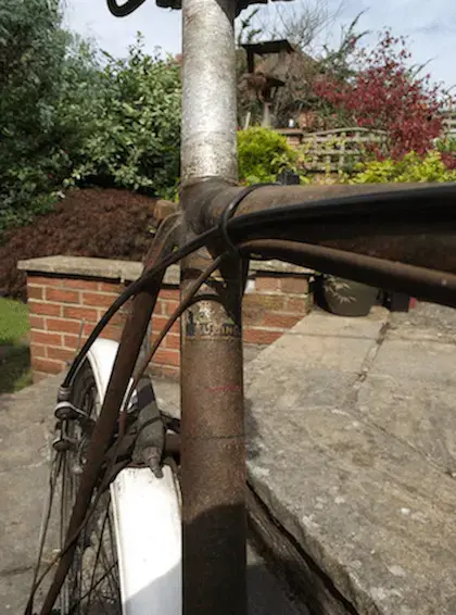

Could you post some pics up of the frame? I'm currently trying to indentify what I believe to be a 1940's Claud Butler. Was the serial number on a rear dropout?
Chris.
PostPosted: Wed Sep 25, 2013 5:14 pm
Newbie
Joined: Wed Sep 04, 2013 12:05 pm
Posts: 5
Hi Chris
The frame number of my Claud Butler is underneath the bottom bracket. There are some photos on flickr(too large for here) http://www.flickr.com/photos/67082177@N02/
If there are any parts of the frame that you would like me to photos them just tell me and I will post them on Flickr
Cheers
Ian
