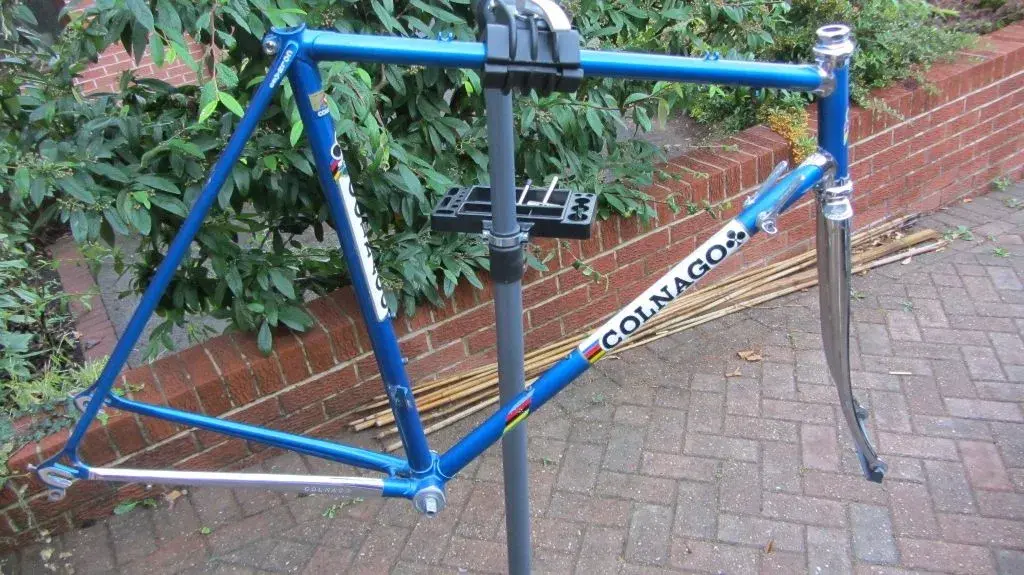

Hi folks,
I was recently lucky enough to acquire this Colnago frame. I intend to rebuild and use it with period correct parts as far as possible. Would appreciate your views on when it was made and what the original component spec would be.
A few notes:
1. It came with some C Record bits
2. It has a club shaped cut out in the BB
3. There is an unusual braze on under the top tube
Any help much appreciated :D

Hi - I almost had a bid on this one myself!
Early 80s.
Assuming the forks are original, I'd have this as an '82. According the the Colnago dating information available elsewhere (Ithink my copy came from the Classic Rendezvous forum), the stamped chainstays arrived circa '82 and that was the last year of the square fork crown before the sloping version in '83.

Excellent, thank you.
I have spoken to the previous owner who says he bought it as is s/h in 1985 and was told it was 3/4 years old at the time. Ties in well with your dates. Is there any way of discovery the original or period spec?
Dave
