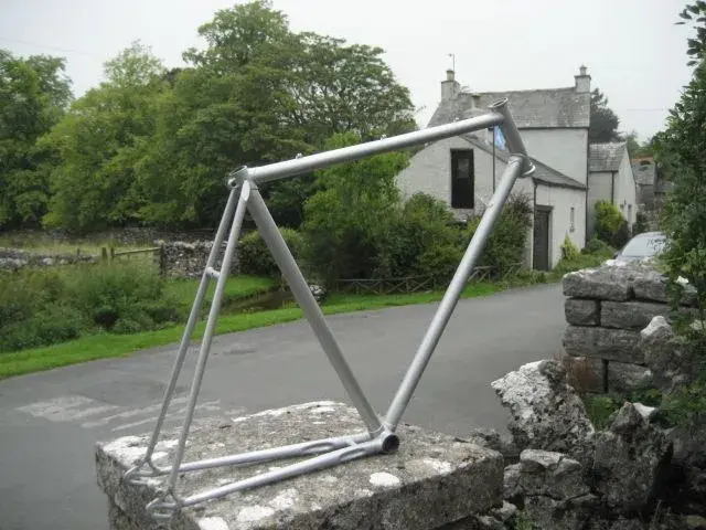

I have recently been given an old frame. It has been repainted with no decals, but I have a photograph of it pre-painting which shows Harry Quinn decals on the seat tube and top tube, and what are probably Reynolds decals near to the top of the forks and near to the top of the seat tube. I've no reason to think that it's not a Harry Quinn, but as yet I haven't managed to find a frame number (it doesn't seem to be on the bottom bracket). I really don't know how old it is, but it just looks old to me.
However there are a number of unusual features (or at least they are unusual to me) which might help date or identify the frame.

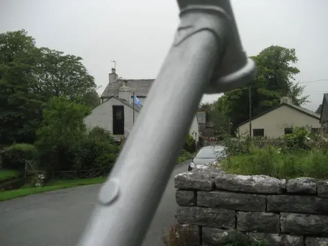

There is a disk (approximately 12mm diameter) on the down tube in the approximate position of the gear shift levers. Any ideas what this is?

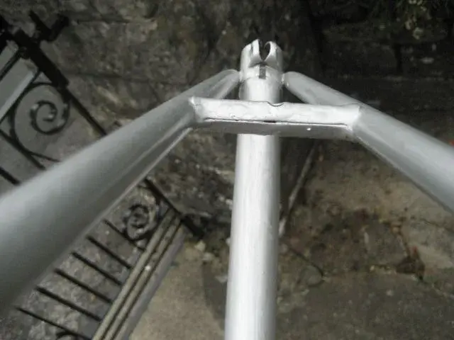

The brake bridge and the bridge near the bottom bracket are not made from tube, they just seem to be rolled plate. Is this common?

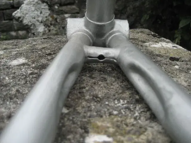

There are small holes near to the top and bottom of the chain and seat stays. Are they vent holes?

File comment: Seat stay and brake bridge
File comment: Vent holes

File comment: Disc on down tube
File comment: Frame

The disk on the downtube is the location point for band on type gear levers, sometimes they are under the tube. The gear cable guides around the bottom bracket and at the rear of the chainstay will also have been for the band on type.
If its a Harry Quinn frame they would be a serial number under the bottom bracket beginning with Q. The Q is also quite distinctive as it was struck as an 'O', then struck with an 'I' to form the tail. The paint looks quite thick so it maybe obscured. However, even without the frame number the rolled tube bridges don't have the look of Harry's quality building. I'd say it could be 60s early 70s frame, but it doesn't look like one of Harry's.

One of the problems is that when Frank Clements owned the brand in the early 80's all sorts of frames were branded 'Harry Quinn' from 753 to gas-pipe (mostly the latter!). If it IS an HQ then more likely one of Frank's - but the number will tell us (if there is one!). Numbers Q5*** are often Franks' ones.
I can't see Harry using bridges like that although the lugs and dropouts look reasonable.
EDIT - in retrospect, FC may not have supplied 753 but definitely 531.

I own a Liverpool made Quinn, and have seen enough Liverpool frames to know that he'd not use bridges like those in your photos.

A very cheaply mass produced frame.
Crimped chainstays were rarely used by quality builders.
And those very cheap and poorly finished bridges?
Gas holes also rarely needed by small builders,

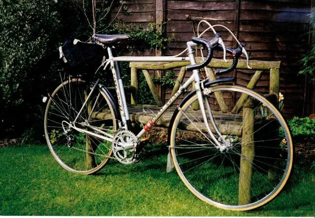

In reply to "Dirt Disciple" I've attached a photo of the bike pre paint job. It's not a very good picture (it's a scan of an old photograph), but you can make out the Harry Quinn decals plus what I am told are Reynolds 531 decals. Don't take too much notice of the other components as the bike may have been put together from bits from the shed.
I removed some paint and so far haven't found a frame number, but the front dropouts are stamped GIPIEMME. If it's relevant, the frame weighs about 5.0lbs (about 2.25kg) and the forks a further 1.75lbs (about .81kg).

Also can anyone explain exactly what the disc on the top of the downtube is for (see earlier photo)? I understand it's to do with clamp-on levers, but don't understand why or how. I've looked on the net but haven't found any examples.

Frames often had some sort of "stop" brazed on the frame to prevent the band of the shifters moving downwards.........usually a small triangle under or on top of the frame....
http://starostneradost.files.wordpress. ... retrfr.jpg
could be any shape though.

Totally agree as no specialist framebuilder would be brazing bridges this bad!!!
