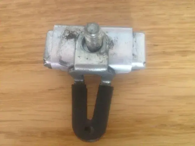

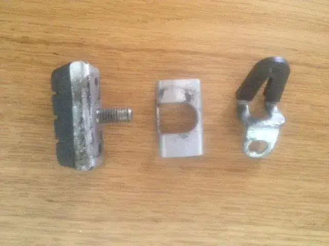

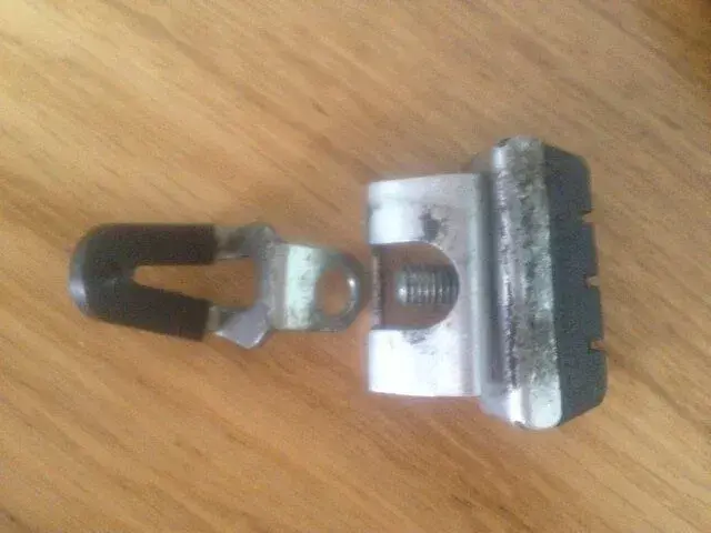

Hello... it's another appeal for advice from someone who doesn't know what he's doing and is trying to learn.
I thought that replacing the brake blocks on the Peugeot Triathlon that I recently bought off eBay might be a clever thing to do, as it looks like the brake blocks on it might have actually been original equipment.
As I've only ever had bikes with basic brakes before, I've encountered something new - a sort of assembly that holds the brake block in with a 'v' device. The simple kind of sidepull brakes i've had before just have a brake block assembly bolted to them and that's that.
I've taken a few photos of it... and the blocks that I bought as a replacement from my local bike shop, the brilliantly-named Ken Foster's Cycle Logic.
But I didn't have the bike with me at that point, so I just said I needed blocks for Weinmann brakes and the last photo is what they sold me.
How important is that 'v' assembly? Should I take those blocks back, and look for some that are a size that would fit into it?
Many thanks in advice,
Drew

I doubt if it is necessary at all. I think it is just a wheel guide to 'help' refitting the wheel. Several brake manufacturers started fitting them as a copy of the original Campagnolo design. Unless you're an absolute numpty who can't refit a wheel into a bike without mechanical assistance of dubious worth then forget them.

As Old Ned says, they are wheel guides. cheaper brakes like weinmann had them attached to the blocks. My Shimano brakes have grooves milled into the calipers to hold them.
BITD I used to sit on a moving car window behind the bunch, wheels ready, set to leap out and swap a punctured wheel as fast as possible.............might have been helpful then but more a fashion statement otherwise :D
