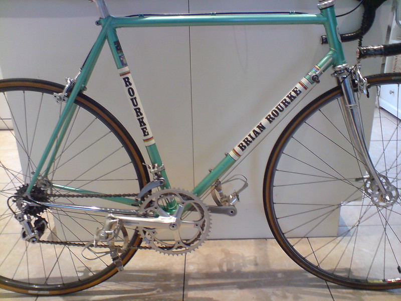

Hi
I recentley posted Some photos of a bike I bought and the replies I got were really helpful.

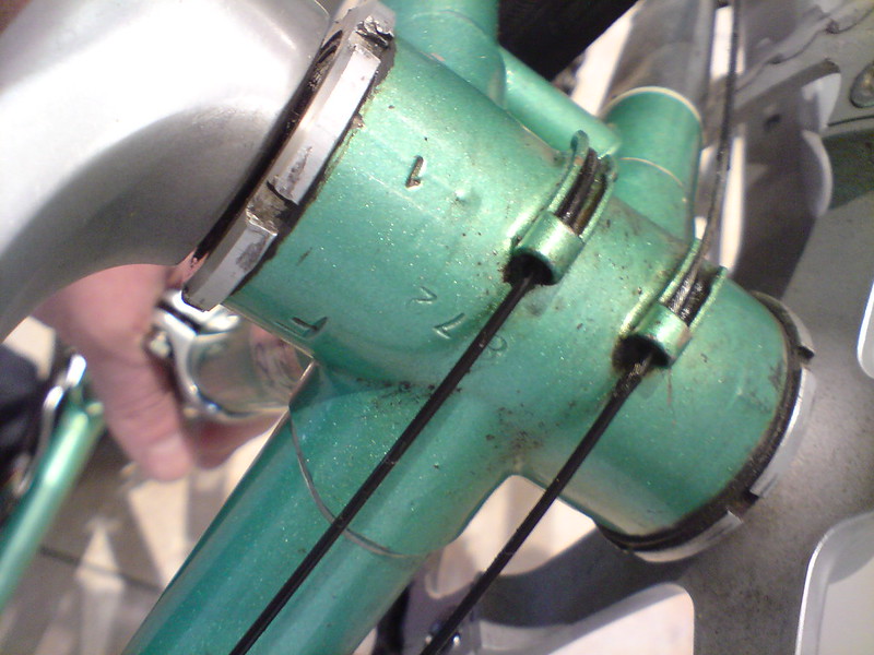

I've sent an email to rourkes with the frame number which is 2156 (stamped on the frame and on the forks), hoping they could verify that it was actually a Rourke. As of yet they haven't replied, so i'm hoping someone might know if that sounds like a Rourke frame number!
When it was stripped the paint paint looked very original near the decals and on the openings of the tubes but it had been touched up (badly) over the years.
Any help would again be much appreciated
thanks Gary

Jason Rourke of Brian Rourke Cycles has been responsive to bike inquiries. IMO, The lack of wrap around seat stays, a Rourke build tradition would create some doubt that it is a Rourke.

As far as I am aware (and I'm pretty sure of this), if a frame does not have wrap over seat stays, then it was not made by Rourke. Although, I have seen many frames painted by Rourke and wearing the name.

Rourke do use frame numbers or at least they did on their earlier frames, although as has already been pointed out, wraparound seat stays would be typical of rourke. To get more info you could try posting on London fixed, Jason rourke is a member there and should pick up on the post.

Mine was under the bottom bracket, No. 872. Built by Paul Washington paint by Bob Dawson. I can't find the date now but I think it was 1980, not sure that sheds any light on their numbering system :?

Apart from the lack of wrapover seat stays the forks[if origonal] don`t look quite right
