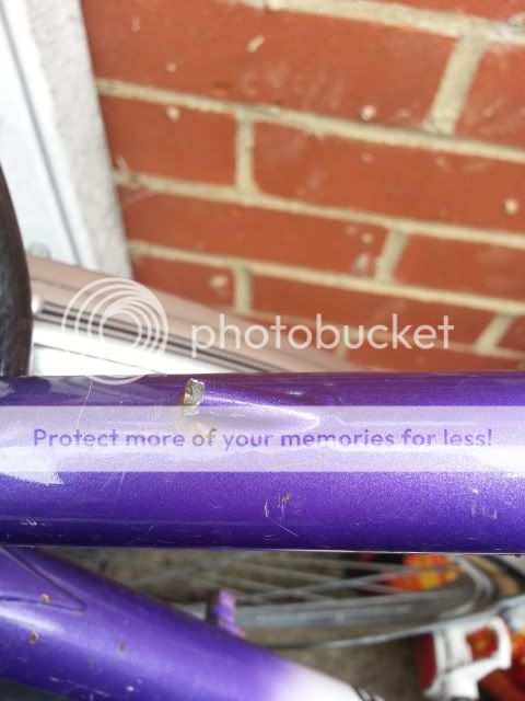

I'm in the process of fitting a rear brake to my work bike (was fixed, now have a freewheel). The routing looks like this:
Can anyone assist?
PostPosted: Fri Aug 23, 2013 1:00 pm
Joined: Mon Jul 15, 2013 2:10 pm
Posts: 78
Location: Hungary
Use the brake cable ferrule which fits into the hole displayed on your photo. Inside the tube the pure cable must be run.
PostPosted: Fri Aug 23, 2013 1:14 pm
Joined: Fri Mar 02, 2012 7:46 pm
Posts: 535
That means the outer cable has nothing to fit into from the lever to the top tube?
PostPosted: Fri Aug 23, 2013 1:31 pm
Posts: 78
Location: Hungary
I don't really understand your question. The whole stuff must be installed as you do for example in a case of a mountain bike. Inner cable, outer cable housing (from the brake lever to the hole of the top tube) with two stops at the both ends of the outer housing.
The inner cable can be pushed in the tube, because the tube must have an inner guide, which will drive the inner cable to the right direction inside.
PostPosted: Fri Aug 23, 2013 1:36 pm
Joined: Sat Oct 06, 2012 5:17 pm
Posts: 3775
Location: Norn Iron
Does this help?
Cable outer has an end as it enters the frame.
Richard

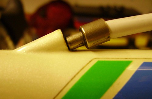

PostPosted: Fri Aug 23, 2013 4:27 pm
Joined: Tue Feb 23, 2010 1:56 pm
Posts: 1040
Location: West Yorkshire
Can anyone assist?
Your cable entry point looks the same as my Daccordi and I used to use standard ferrules but was never happy with them. I now have stepped ones like this and they're much better as the outer cable doesn't slop around. I have no idea where they came from though.
Obviously, I have pulled the ferrule out of the cable tube to show the design, it normally sits nice and flush.
Mark.
