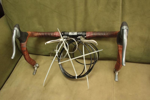

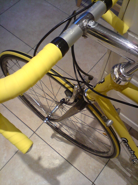

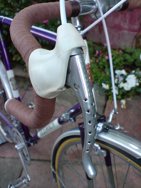

Hi Richard

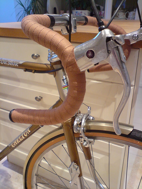

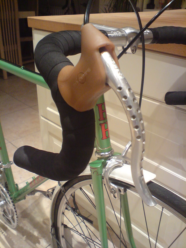

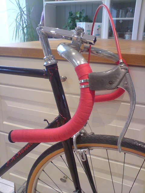

I find it varies depending on which tape you use and it will either go right first time, or you'll have to mess around for hours :) Cushion tape can have a wider wrap than cotton tape. I always start at the end of the drop, wrapping outwards from the frame. Keep a good firm tension throughout. Use a short piece to cover the brake clip, either vertically or horizontally, when you get to the end trim at an angle so it wraps squarely around the bar and secure with insulation tape. Bobs your uncle, Fanny's your aunt :)
Cushion:
Cotton:
Leather:

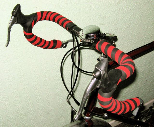

Nightmare: :facepalm:

Re nightmare, how do you do that then? Love it!

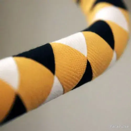

Double

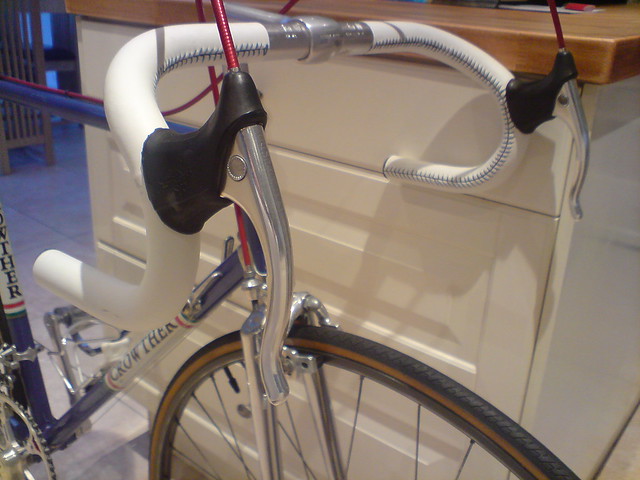

Leather
