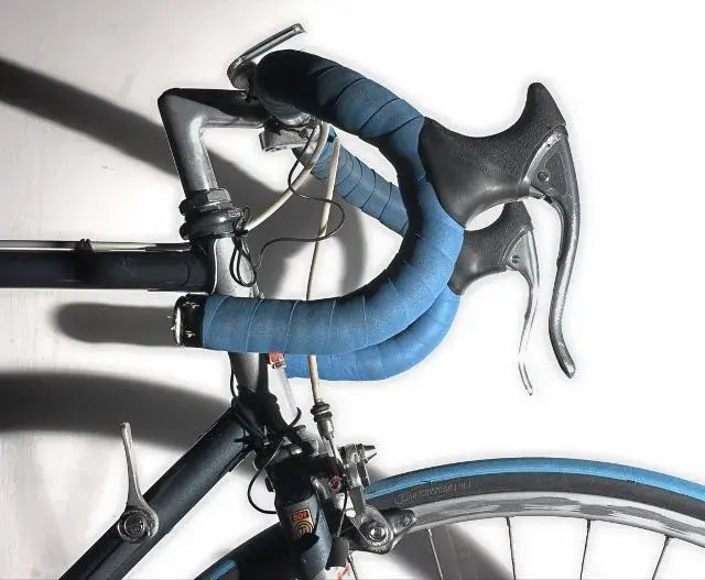

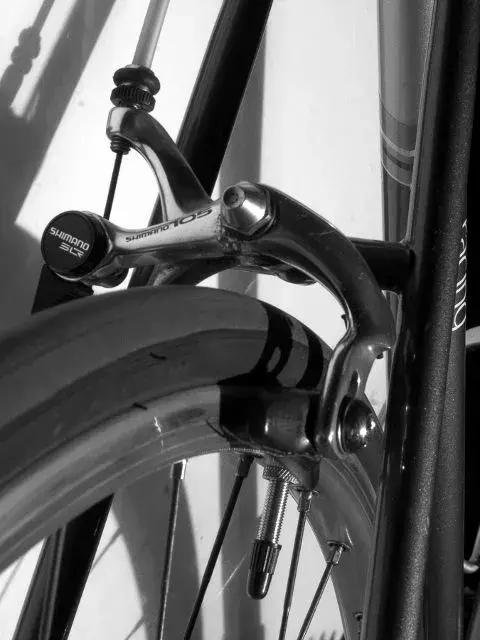

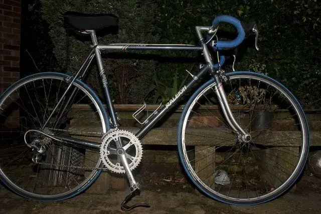

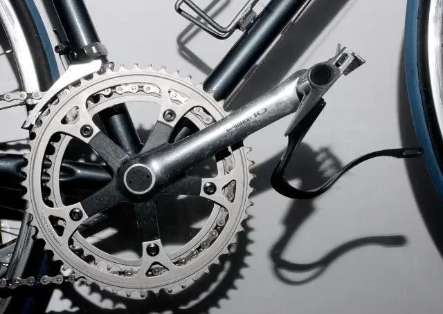

Hi i also have this bike but with all original parts. It has Shimano 105 brakes and gearing. It has weinnman 700 rims the only difference to your bike is the SR road champion handlebars.I ve uploaded pics so you can have a look.
