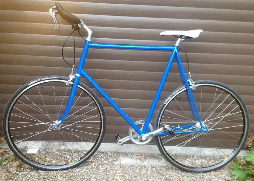

Cheers Steve. The fork I'd like to stick on is a really light (Columbus maybe) and would go a treat on the bike. A new 1" threaded fork with a huge steerer is proving trick to find. The bike is a beast!
Take the thing (not the bike) to your local engineering/machining shop. They should have the gear to easily do that.
Good plan! Would you suggest having the old steerer removed and placed on the new forks, or an extention added to the new fork steerer? If a new fork, is the steerer welded or brazed?
Cheers for replying!
Jon
Frame looks like it has brazed on bottle holders so isn't a complete gas pipe job.........
Forks are one of the things that get me a bit twitchy, lots of things cabn go wrong on a bike and all it does is grind to a halt. The forks failing is possibly a face on the tarmac job, and it looks like you have quite a way to fall. It shouldn't be an expensive job to get the sterrer modified by a real framebuilder.
Doesn't have to be a large business, a single handed person like Kevin Winter could do it :)
All IMHO
Shaun
They would weld it as It would be stronger, but I don't know what the original one is, that's probably brazed to the crown.
I have read about someone else doing the same thing, I'll try to find it.
As Shaun says, make sure they are a good quality shop not a local garage.
